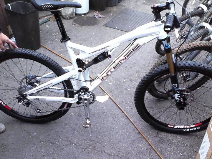

    So heres the bike with the 1x10 setup!
    I still don't have it in my hands...I'll go pick it up next week!
    When I saw it I immediately noticed the perfect chain line! No rubbing, no weird things...I rode it around the block, and it feels soooo smooth! Shifts perfectly! No regrets whatsoever!
    specs upon request...nothing fancy.

    Quote Originally Posted by dhbomber
    Make sure you wrap your chainstay up with some old innertube and cloth tape or it'll look like a bb-gun target in no time. Nice bike!
    "It looks flexy"

    Quote Originally Posted by gticlay
    I plan on wrapping it with some clear material...I don't know what material to get yet...Something thick...
