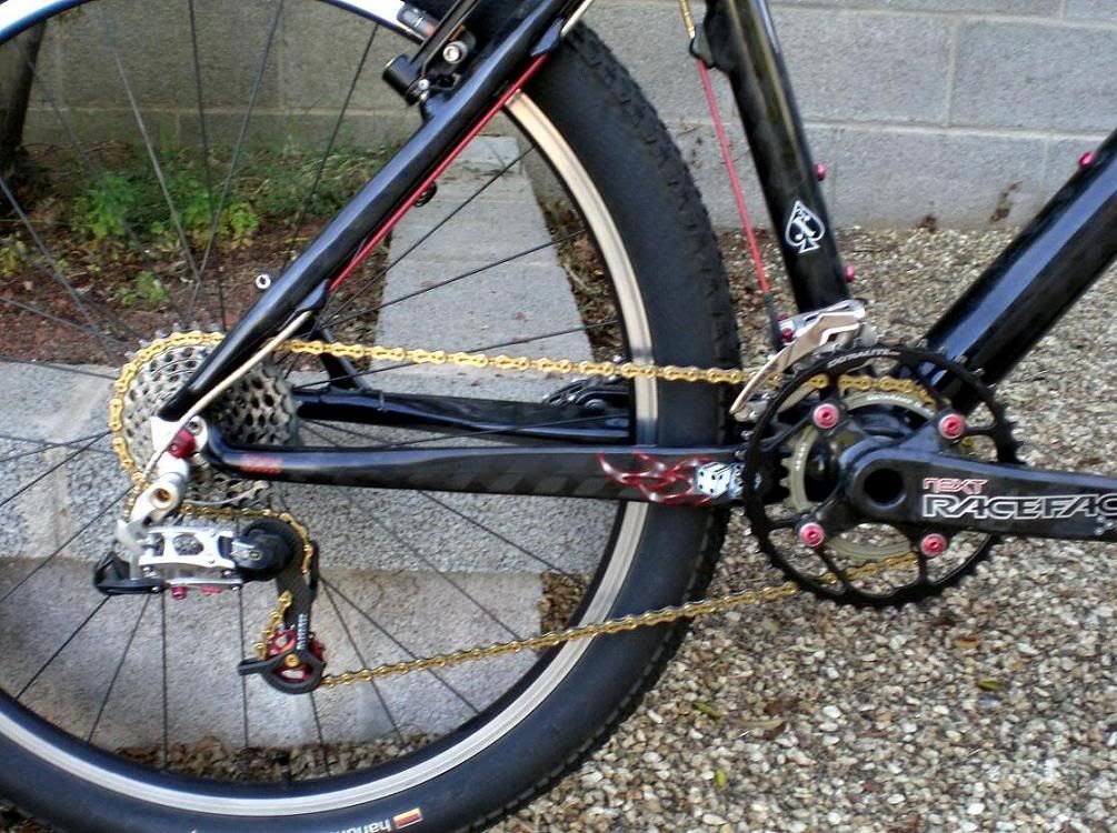

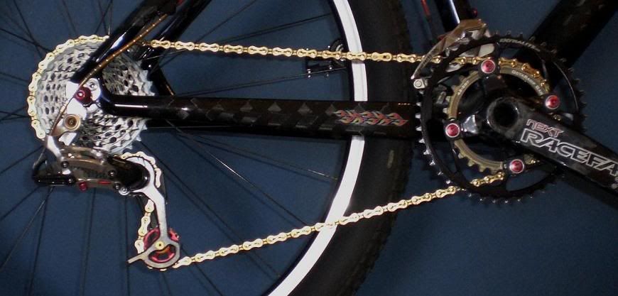

    Caution;  Merge;  Workers Ahead! Setté Serum Carbon Frameset Build 17"
    Sette Serum Carbon Frameset 17"
    If you are assembling the ultimate XC race bike, you'll need the Serum frame. Using the latest in hi modulus technology, the Serum uses a 3k filament weave for the best in strength to weight ratios. Our integrated cable routes are tubed so there's no fishing to try to find your cables. Every detail is addressed on the Serum Elite so you can build the race bike of your choice from the ground up.
    Features:
    -Weight as low as 1055g (15")
    -3k filament weave, hi modulus carbon fiber technology
    -Accepts 31.6 seatpost
    Old Specs List
    New Updated Specs List
    1246 grams is frame and the seat post clamp combined. its overweight.
    1246 grams = 2.74695979 pounds
    BUILD SPECKS:
    Frame
    3k Matte Finish
    Size(s)
    17 Inches
    Fork
    Fox 32 F-Series F-100 RL / 100mm Travel / Black
    Shifters
    Sram X.0 Trigger Shifter Carbon, 9-Speed
    Front Derailleur
    Shimano XTR FD-M970 34.9 Clamp
    Rear Derailleur
    Sram X-9 Medium 9 Speed
    Shifter Cable/Housing
    Shimano XTR
    Brake Levers
    Shimano
    Front Brake
    Shimano XT M775 Hydraulic, 160mm Rotor
    Alligator Serration Disc Brake Rotor
    Rear Brake
    Brake Cable/Housing
    Shimano
    Crankset
    Shimano FC-M970 XTR Crankset , 44x32x22T
    Bottom Bracket
    Shimano XTR, included w/Crankset
    Cassette
    Sram PG 990 Cassette 9 Speed 2009
    Chain
    Sram PC-991 9 speed
    Headset
    Cane Creek ZS-3 Zero Stack Headset
    Handlebar
    Easton MonkeyLite SL Riser Bar Carbon
    25.4, Lo Rise, 610mm
    Grips/Tape
    Esi Grips Chunky
    Stem
    Race Face Deus 6D Black 25.4mm
    Saddle
    WTB Devo SLT Ti Black
    Seatpost
    Easton EC70 Zero Setback 400mm 27.2mm-shim-31.6mm
    Wheelset
    Mavic Crossmax ST Disc Wheelset 2009
    Pedals
    Crankbrothers 2Ti Eggbeaters
    Front Tire
    Performance Forte Sherwood XC 2.1
    Rear Tire
    Color(s)
    Matte Finish
    Warranty
    5 Years
    Weight
    21.9375 pounds
    Frame Only Pictures
