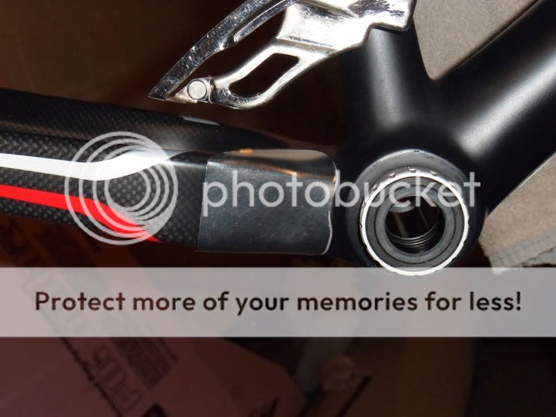

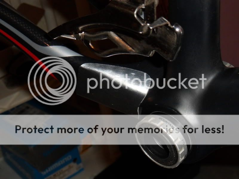

    I recently built up a Sette Serum and was concerned about the possibility of chain suck messing up the frame. After looking around the Internet and not finding a good solution, I decided to make my own. I ended up using aluminum flashing for roofs and 3M Auto attachment tape. Below are some pictures of the final product.
    <a href="http://s829.photobucket.com/albums/zz212/Laser4G63/Bike/?action=view&amp;current=CSProtector2_zpsd2d06469. jpg" target="_blank"><img src="http://i829.photobucket.com/albums/zz212/Laser4G63/Bike/CSProtector2_zpsd2d06469.jpg" border="0" alt="Photobucket"></a>
    <a href="http://s829.photobucket.com/albums/zz212/Laser4G63/Bike/?action=view&amp;current=CSProtector3_zps0cb9325f. jpg" target="_blank"><img src="http://i829.photobucket.com/albums/zz212/Laser4G63/Bike/CSProtector3_zps0cb9325f.jpg" border="0" alt="Photobucket"></a>
    <a href="http://s829.photobucket.com/albums/zz212/Laser4G63/Bike/?action=view&amp;current=CSProtector1_zps6e5bfa31. jpg" target="_blank"><img src="http://i829.photobucket.com/albums/zz212/Laser4G63/Bike/CSProtector1_zps6e5bfa31.jpg" border="0" alt="Photobucket"></a>

    Thanks. It's not that hard since flashing is very easy to bend. All I did was make a template out of thin cardboard and trace it on the aluminum, then cut it out using tin snips. Applied the 3M tape and trimmed it with scissors.
    After my build and upon making adjustments, the chain dropped a few times as well and was hard to get out. I don't like that either and wish there was something to put there. If I did make something to put there, it would have to be a thicker aluminum that what I used here.
