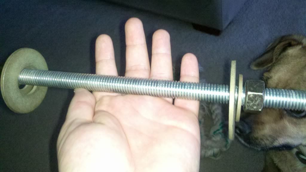

    First question, is it worth it to purchase a headset press? Fashion a ghetto press with a threaded rod, wing nuts and washers? Or just take it to the LBS?
    Nov 2008
    13
    I've used a ghetto press a couple of times with no issues on a Sette Ace and Flite. As long as you have everything aligned then you'll be okay. Just go slow and make sure the headset lined up as your turn it.

    Ghetto Press all the way.
    Actually, I used the Headset Replacement instructions here:
    http://www.utahmountainbiking.com/fix/
    I'm not ashamed to admit that a hammer was involved. No issues.

    Well, still waiting on more parts to arrive, but I did make a little home-made press. $8
    My dog thinks it's a bone apparently.

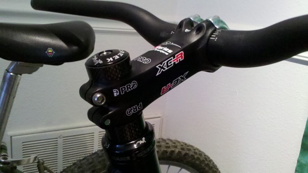

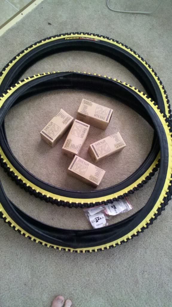

    So my next shipment of parts arrived this evening! Overcame the first thing I was worried about in this build, installing the headset!
    Need to run to Lowes tomorrow to get a nice pipe cutter and take care of that tube length! Also got my tires, tubes and rim tape. Wheelset still on its way.

    Those tires are crazy! You gonna have any other yellow accents?
    I have yellow Oury grips coming, and I was thinking about replacing the seatpost clamp that came with the frame with a yellow one. Don't know how much more I'd want to do in yellow though

    While I'm waiting for parts, here's 2 more pics that were still on my phone.
    Headset installed. Left it a bit long so I can move it around once I get it on the trail. Depending where I like it, I may cut the tube again.
