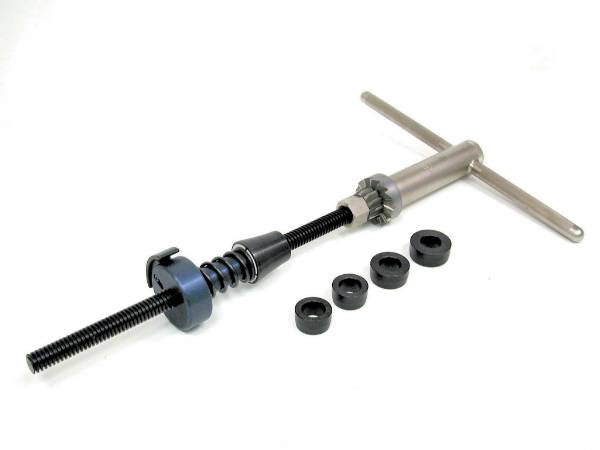

    i read on here that you should "re-face" the head tube & bb shell - like the lip areas? is this absolutely necessary? or only if lip is damaged? Can i just throw on the headset & BB as-is?
    or not recommended? i havent built up a rapport with any LBS's yet ...if i just go to the closest one, what do i say? ... i feel i might have an anxiety attack & run out lol jk
    Reputation: Dremer03's Avatar
    3,656
    I didn't do it on my Reken, and I have no issues. People say you do it to get a good seal, by having a flat surface.

    They dont always need to be faced , although its certainly a good idea to check them .

    What head set and BB are you using? You also should have the threads in the BB shell chased.
    Reputation: pulser's Avatar
    Dec 2004
    1,826
    Quote Originally Posted by Dremer03
    Its not really to get a good seal. The flat surface is important so the bearings are properly aligned and don't bind. Lower end and middle of the road head sets usually have enough slop in them to make up for small amounts of misalignment.

    Your LBS likely has the facing tools and can check it for squareness and the need for facing . It only takes a few minutes to check it , and dosent cost a whole lot if it needs to be done . If it does need to be done and you forego this step you could ruin some bearings in very short order . If you would like some other opinions feel free to post a question in the bike and frame forum , I'm sure you will get plenty of excellent info .
    2,658
    nate I would get it checked just incase...bring the frame with you next time and we'll hit the shop after the ride.

    Have your LBS face and ream the headtube, and chase the threads in the BB. This would not be a case of "re-facing" as the head tube on this frame has not been faced at the factory. As people have said, you should ream and face to ensure a perfectly square bearing surface. This ensures the bearings are loaded evenly and correctly, and it also helps to make sure the cups have a perfectly clean and even surface to get pressed into, which will make sure you do not get creaks down the road. It has nothing to do with a "seal." Facing and reaming is one of those steps a lot of people skip because they do not have the tools. Sometimes nothing happens, sometimes you end up with a creaky headset. When building any bike from the frame up, I am always of the mindset "if you're gonna do it, do it right the first time."

    Park precision cutting tools are some of the nicest tools I have used (for anything - bike or other) and cost close to $500 for the base setup for a reason.
    http://www.parktool.com/products/det...51&item=HTR-1B
    But that basic setup does not include the whole slew of adapters and other cutting components needed to address the crazy range of bike setups out there. It represents a significant investment for a shop so they will probably charge you a minimum of $30 even though it is a relatively quick job. As you said, this is a great opportunity to strike up a good relationship with a good shop - a relationship that will be very valuable for as long as you are riding.
    The BB facing/tapping setup is also a beautiful precision tool.
