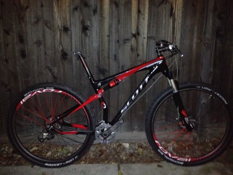

My New Toy!!! 2012 Scott Spark Expert
Here it is completely stock out of the box with tubes, came it at 26.3lbs It is getting torn down and hopefully put on a 3-4 pound diet in the next week. I have a 29er Scott Scale RC frame ordered as well.

It's a size large. Just changing it to tubeless with drop almost a lb. going tubeless with some crests will drop it almost 2 lbs I would suspect. As far as the rest of the weight, it will be getting a full XX drivetrain, formula r1 brakes and a few light weight adjustments, I already started tearing it down and recording weights of the stock stuff so I'll post it up when I'm done.

going from the pro's wheelset to crest shaves more than a pound. going to crests from those wheels should be almost 2 pounds, if not more!

Ok I broke everything down and weighed it, at least for the most part. I didn't feel like taking the fork off so I weighed the Fork/Frame/Headset/BB/Seat collar/Rear Shock remote all together. So here you go.
Fork/Frame/Headset/BB/Seat collar/Rear Shock remote...4370g
Grips...115g
Front Brake...285g
Front Rotor 180mm...133g
Rear Brake...285g
Rear Rotor 160mm...90g
Handle Bars...281g
Stem...141g
Front Shifter + Cable...144g
Rear Shifter + Cable...153g
Total Cable Housing...70g
Chain...270g
Rear Derailleur...229g
Front Derailleur...150g
Crank(No BB)...771
Cassette...348g
Seat Post...315g
Seat...267g
Tubes(X2)...155g Each
Tires(X2)...530g Each
Front Wheel(Skewer+Rotor Bolts)...970g
Rear Wheel(Skewer+Rotor Bolts)...1225g
Total...11982g ( 26.3lbs )
Just to give everyone an idea of where you can loose weight easily. The wheels are an easy spot can almost loose 2lbs just right there with a nice upgrade and going tubeless. Hope this helps.
Chris

Those wheels are definitely boat anchors. Also can lose close to 100g with foam grips..

Ok so I broke it down even further. Fork was 1604g the frame w/ shock/remote/BB is 2450g. What sucks is after weighing everything if everything would hit its claimed weight then this bike would be a pound lighter out of the box. But mostly everything Ive been able to find is over claimed weight!!!

Alright the tear down is complete and it's almost all together, just finished for the night thought I would throw up a teaser.
Weighed in at 20.4 lbs, still waiting on a few things
EC90 Seat Post
Thomson Seat Post Collar
Thomson Stem
XX Cassette
This is going to be it's race weight, wheels will come off for regular riding, weight should come in around 21.5 lbs. This beauty lost 5 lbs!!

Ok it's finished for the most part. Don't have a final weight yet because a few things will be changing. Decided to go with a Thomson Masterpiece seat post and I am picking up my XX cassette tomorrow and the rear titanium skewer I got didn't fit. With my heavy pedals as is right now it weighs 22.8lbs. With the other changes and light pedals it should be right around 22.1/22.2. I didn't go super light weight on anything could probably get it close to 21lbs even with a little effort but this is going to be my trail bike, wheels will only go on for races. Now hopefully I can get my RC frame next week and start building that.
And last but not least you cant forget the Mojo!!!
