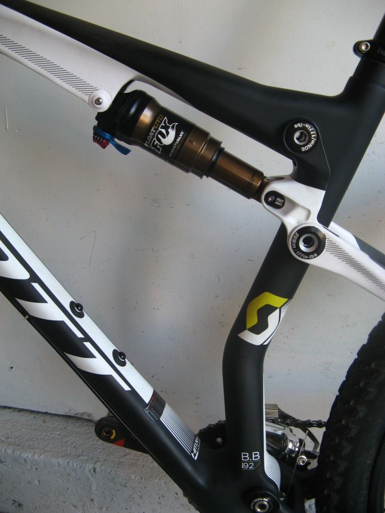

    I have just swapped my DT shock on my 2012 29er for my 6 year old Float RP2 off an old bike. The difference was night and day. I have chopped off the remote cables and will never use DT shocks again. Mine wouldnt lock out after a years use and had horrible feel. The fox with propedal on has no pedal bob yet still soaks up bumps, propedal off is plush plush plush descending. When I can afford a new Fox I will go for it, I wont worry about remotes again. This was my main gripe with the spark like many others. Problem solved at no cost=happy wife!

    I've looked into it enough to learn that Fox does not make a 6.5" long x 1.5" stroke CTD shock with Boost Valve. Apparently they may have been made for some OEM applications in this size but they are not available for purchase aftermarket. So the potential CTD shocks for the 2nd gen Spark are the base Float CTD model or the Float CTD Remote model. I didn't look into the iCTD any more than learning it costs mega bux ($1000+) and I don't think you can even buy one right now anyway.
    I'm thinking of getting one of the two CTD options. I think I'd prefer the remote shock but I'm not all that interested in using the gargantuan Fox lockout lever. No word on if the twinlock lever will work for it and I doubt anyone can say if it will work without just trying it. I may just order the CTD Remote shock and see if it works. If it doesn't I'll return it and get the standard CTD shock. Price difference is $375 vs $395 so not much incentive there. The Fox lockout lever runs $80 though so if the twinlock lever doesn't work, you'd be spending $100 extra between the added shock cost and the lever.

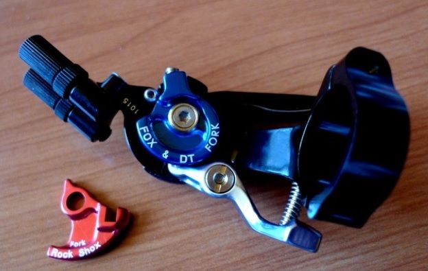

    I just put a CTD remote on the 2013 Spark. It sort of works with the Scott lever, but you have to change the small removable disc in the lever from the NUDE2 one to the FOX one which should be available from Scott. But, it takes a TON of force on the lever to switch it into the 3rd position. I talked to the service manager at fox and he said their Twinloc will work better than the Scott since it has a much longer lever and definitely pulls the correct amount of cable (He was dubious that the Scott lever had the correct pull radius even with the Fox inserts)
    So, sounds like your best bet is to buy the Fox lever or to go with the standard CTD with the switch. An added bonus of the CTD shock is that it can be mounted upside-down which actually leaves room for a large water bottle in the cage! (gasp)

    Actually, I have it set up now with the Scott lever (with the Fox inserts), and it seems to be working correctly. I will compare once the Fox lever comes in. You'll need the mounting hardware too, it's the 6x22.2 mm spacers on both sides.

    Couple more questions. What "disc" did you swap? The one bolted to the bottom of the Twinlock and intended to be used for different forks (i.e. the one in the picture)? Or did you swap out the main lever that currently controls the rear shock?
    I contacted Scott and they knew nothing. Said they had no idea if you could control a Fox rear shock with their lever. Kind of odd since I'm sure it has been tried by them. Perhaps I just didn't get in touch with the right person.
    So would you say that the Scott Twinlock works ok or not? Earlier you said it takes a ton of force. Is it still ok or would you say it is simply too much and it doesn't really work?
    Are the spacers you mention for the shock the ones that come with the Fox shock? Or are they something you had to get independently?
