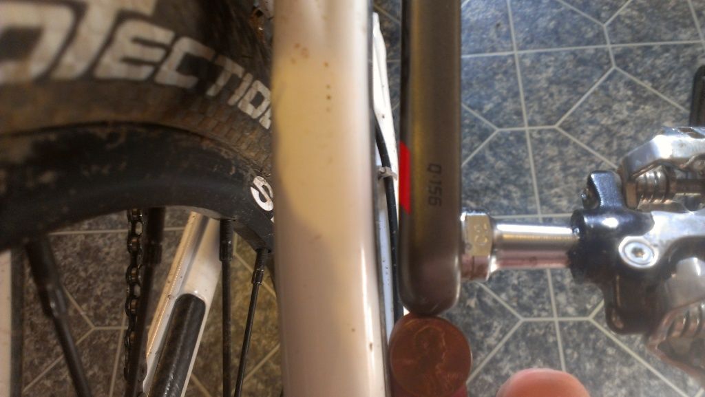

    I have a 156 xx on my tallboy. I'll swap it onto my Trc when I get home this evening. Let you know.

    354
    156 on one side 168 on the other. The 156 on the tbal has the clearance of the 168 on trc

    Wow - so much for that idea! Thanks so much Mr. Kidd, you've saved me a lot of hassle.
