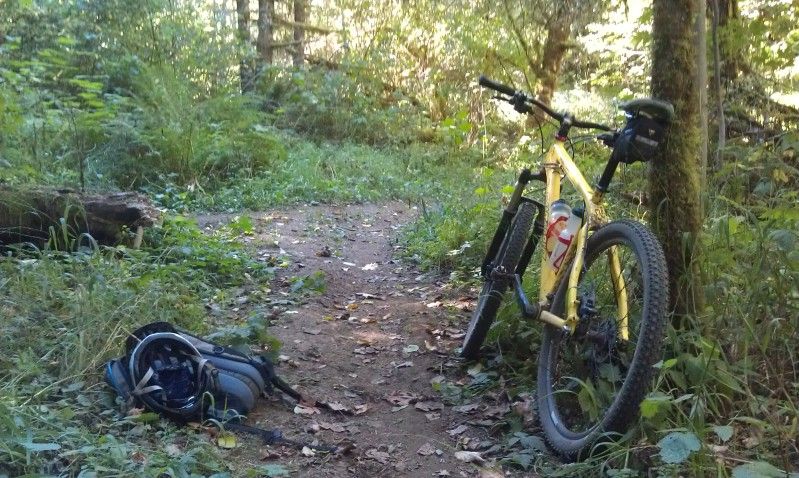

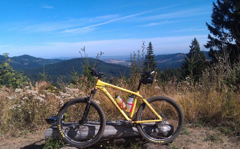

    Update and Upgrades!
    Quote Originally Posted by njonesy_07 View Post
    Yup, just straight yellow. Its been used (obviously) so in the sunlight it may seem a bit more "dull", not quite as vibrant yellow as it once was.
    I enjoy the bike too, its great. I just need to lighten it up a little bit and it'll be perfect. I'm really wanting to get a Rockshox Revelation for it, the Domain 318 I have on there is very heavy and more travel than I really need. I'm running a 22/36/bash with an 11-34t cassette. I can get that baby to climb up anything in the "granny" while maintaining good pedaling speed on flat and downhills.
    I'm going to call Santa Cruz and request new stickers for it. I am very tempted to ask for silver stickers, as I may end up powdercoating the frame red like the one they have listed on the website.
    I love it
    Update!
    Made some changes and upgrades over the summer:
    Sold Rockshox Domain 318 and Bontrager Big Earl wheelset!
    Added:
    -Rockshox Revelation RCT3 Dual Position Air - 15mm QR - 150mm/130mm Travel
    -Bontrager "Duster" Wheelset --> Tubeless
    -Thomson "Set Back" seatpost
    -Easton Haven bars w/ Ergon Grips
    -Shimano SLX front derailleur
    Also added waterbottle cages to compliment the red accent color I'm trying to show. I'll be picking up a red "Salsa" seat post clamp too. Eventually I'd like to rebuild the wheels with upgraded hubs and red spokes or nipples.
    Santa Cruz sent me a full Chameleon decal set up. I will be powder-coating the frame this winter in the same yellow color to freshen it up. I'm hoping to upgrade the shifting group around the same time as the powder coat (X9 shifters & rear derailleur).
    In the meantime, she'll be on the trail as much as possible!
