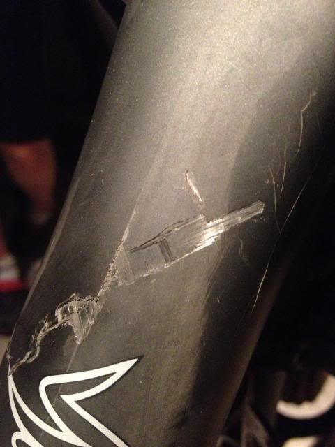

    Highball C, is my frame toasted?
    Long story short, yesterday at the trail found a 3" rock out of a corner and looks like the front wheel got it straight to the downtube, heard it smashed but didn't think it was that bad.
    It's easy to see the paint chipped but I can't tell if the fibers are damaged, the rock strike was not that bad, wasn't even going that fast either but once I got home spotted the crack.
    Been training for a race due this Sunday, does it look safe enough to race?

    Quote Originally Posted by kevocastro View Post
    If that is carbon fiber, its done.
    Once the integrity is compramised its only a matter of time.

    email Willie at SC with pics of the damage. if its bused, theyll have a new frame back to you pretty quick. seems pretty obvious warranty situation .

    To answer your question, it looks to me like there is a real crack running lengthwise on the tube. You may be able to race it and not have it fail but I wouldn't risk it personally.
    SC is very good at helping out but if their crash replacement cost is too high you can easily get that repaired by Calfee or another reputable carbon repair place.

    Well the answer from Santa Cruz is pretty clear, $800 for a replacement...
    I don't even know what to do, so disappointed

    I think you should definitely contact Calfee and see what they will charge to fix it. They do excellent work. A friend of mine had them fix her carbon road bike frame. They did an amazing job. My guess is you can get your frame fixed and buy some frame protection for half the cost of the crash replacement price.
    683
    Yes, check out calfee's site. They should be able to fix that and their prices seem very reasonable.
    Carbon Repair Service | Calfee Design
    5,363
    There is also a very good carbon frame repair place in San Marcos, CA
    Carbon Fiber Bike Frame Repair

    Granted, it would be a bad idea to continue running the frame in that condition, however, has anyone here actually had a damaged downtube fail? I'm just having a hard time picturing that tube separating for less than maybe a chunk 2/3 through the tube missing. Maybe I'm giving CF too much credit.

    No first hand experience, but if you wanted to get some quotes, I've heard good things about these folks as well:

    Thanks all of you guys for the advice, I am gonna take my time to make the best choice
    It really sucks this frame lasted just a lil bit of time (4 months), I read somewhere this forum that a Tallboy crash replacement was about $400...

    On the FS bikes they sell you the front triangle or the swing arm. I know the rear swing arm on the tallboy was in that range. The airline broke my Dad's rear swing arm when I took him to created butte last summer.
    With as many hits as my old lt-c took, I am surprised yours broke easily. It had been part of some spectacular crashes.

    As their first carbon bike, the LT-C was admitedly overbuilt. The Highball, at ~2.5 lbs. is probably less so.
    Fingers crossed that the helicopter tape I put on my Highball's downtube prevents anything like this!

    I have seen an aluminum bike toasted on the first ride when a rock kicked up and dented the downtube. its not any more immune to damage than plastic

    Have that tube prepped and wrapped (at the very least), and you are good to go. Don't toss the frame -THAT would be the waste.
    As for some of the initial replies, seems CF hysteria has not died.
    Oh well, for what it is worth, the world is not ending imminently

    Then either get it repaired or take up SC on their very fair crash replacement cost. It's clearly a freak accidental damage issue, not a warranty situation and I have no doubt Niner would have treated it the same way.
