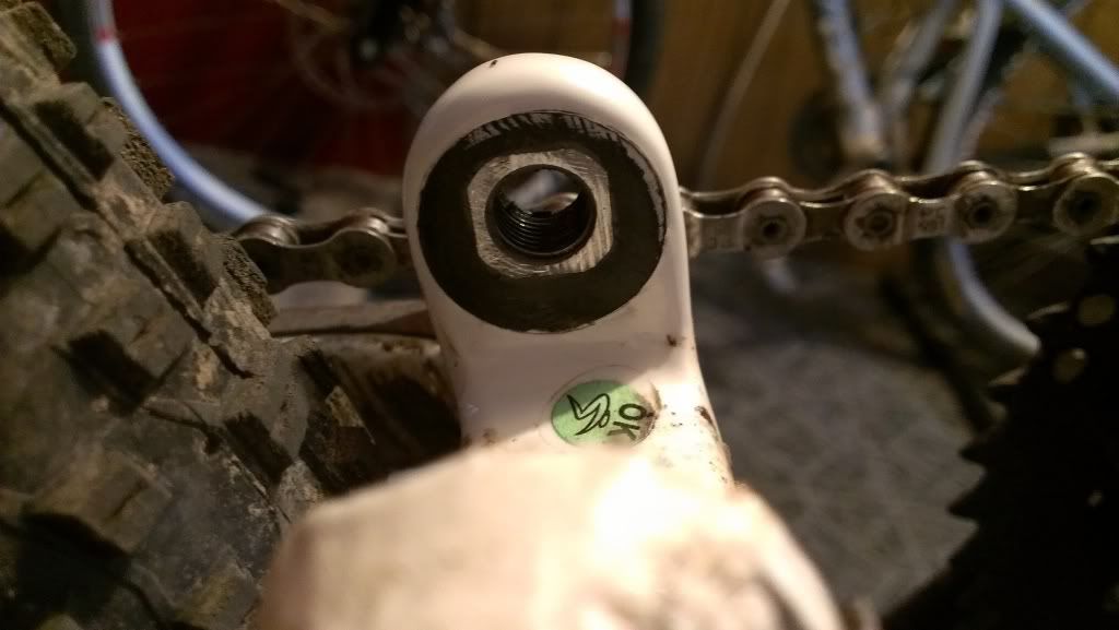

    Here's what the crack looks like:
    That's from the frame that was warrantied. My 2013 frame isn't that bad yet.
    It's not a structural crack in the carbon layup. It's a dis/unbonding (as the thread title says) of the threaded metal insert for the lower pivot bolt and the carbon of the rear triangle.

    Yes the crack does get worse over time. Although, I think you could ride it for quite a while with no adverse effects.

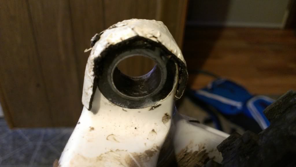

    Here is my crack on my first 2012 frame which was replaced with a 2013 frame

    Santa Cruz replied to my question regarding what changed about the pivots for 2013:
    Quote Originally Posted by Santa Cruz
    Basically we changed the bonded inserts from round parts to square-ish
    parts. You can see this if you look at one of the pivots from the
    link-side. This helps bonding adhesion
    That's interesting to know and it would be hard to notice visually unless you were comparing a 2012 to a 2013 frame. Maybe this combined with the stiffer 12mm axle has reduced the amount of frames disbonding?

    Hm wonder when this change happened? If the insert is now square, how are we seeing people with 2013 frames that has the circular crack? I guess if it was a running change and some early 2013 frames have the old insert and some has the new
    Dec 2010
    159
    Quote Originally Posted by pwu_1 View Post
    The insert for the 2013 TRc is def not square, still circular not sure how he is getting square??
    However if you look at the Bronson, TB2, Solo inserts they are square...
    Somebody with a Bronson please take a photo of the square insert and post it for everyone to see.
    587
    round on my 2013 the drive side is square though

    Square on both inboard and outboard sides? My outboard side is round, not square.
    587
    their all round on the outside.

    I would assume that it's only the drive side that has been changed as (from what I've seen) that's the only side that has been cracking.

    Awesome, thanks! Now if someone can post the Bronson pivot point we can see the difference. The Bronson is co-molded and square on the outside. Looks quite a bit beefier as well.
    587
    i had to check some pics to verify it was the drive side that cracked on my 2012. i forgot. everything is peachy-keen on my 2013 as long as the circus monkey hub holds up.
    683
    my Feb 2012 nomadc was due for a cleaning and greasing so I checked out the pivot areas and no cracks so far! I had a blur ltc for a year and never had any cracks develope on it either. The area certainly looks like it could be a weak link, but there are a lot of people out there riding carbon SC bikes so I imagine it's a very low percentage of bikes that this is an issue with.

    Sorry, it is probably the ones you mention, by kidd and h20-50.
    I just had a look at a mate's 2012 Tallboy Carbon swingarm (142x12 version) and it has the same squared off insert. But it is not obvious that this shape carries all the way through as the outside is painted.
    His brother-in-law also has a 2010 Tallboy Carbon with the same circular crack as shown in a few earlier posts, which he says has been there for over two years, but hasn't developed into any problems with the insert. He's been told to keep an eye on it and let his shop know if anything happens.
    I also had a look at a Bronson Carbon in our local shop today, and again, it's not possible to see the shape from the outside because it's painted.

    I've just found this issue on my white NomadC...assuming they replace it under warranty, will I be given just a white front triangle or a whole new frame with the 142x12 rear??

    Quote Originally Posted by ban View Post
    Yours is cracked on the front triangle? All of these other ones are on the swingarm.
    In any case, I think if they have the same color in stock they'll just replace the part. But if they don't have it then they give you a new frame(you'd just swap the shock over)
  77. #77

    yes it's the front triangle....! I hope they give me a new whole frame!
    I had the same issue with my white Nomad and thought I could do the same thing. I sent the entire frame less the shock back, asked if I could get a new frame in black. SC said they could do a new black front triangle, but I would have to purchase a new rear triangle as a crash replacement for $450.00. They also offered me a set of new links for an additional $250.00 too, but I opted to use my old ones and pay the $450.00 difference for the new rear end only. They also informed me that since my original frame had a QR rear end, they could not sell me a thru axle rear end - even though I was paying for it, which I was not happy about. So after everything was agreed upon on my end, I asked to have my old rear triangle returned to me, seeing I had to buy the new one and they weren't giving me any credit for it as part of the crash replacement deal. They agreed to send it back with my new frame, but a month later when I got my new frame, the old rear end was missing. After numerous phone calls and promises that the rear end would be sent back, they finally got upset with my dealer and said my old rear end was gone and they weren't going to send it back period.
    The whole thing really left a bad taste in mounth and knowing what I know now, I would have never sent the whole frame back.

    Just an update of my broken NomadC frame....I've just received a new green frame, 142 axle included which I didn't have to pay...! cheers Santa Cruz!

    My warranty replacement frame received in Dec. of 2012.
    Waiting to hear back from Willie.

    Quote Originally Posted by mestapho View Post
    damn that sucks. Wonder how long my warranty replacement frame is going to last. At least this time you'll just need a new rear triangle right?
  93. #93
    531
    Ugh I see my resale value continuing downward.
