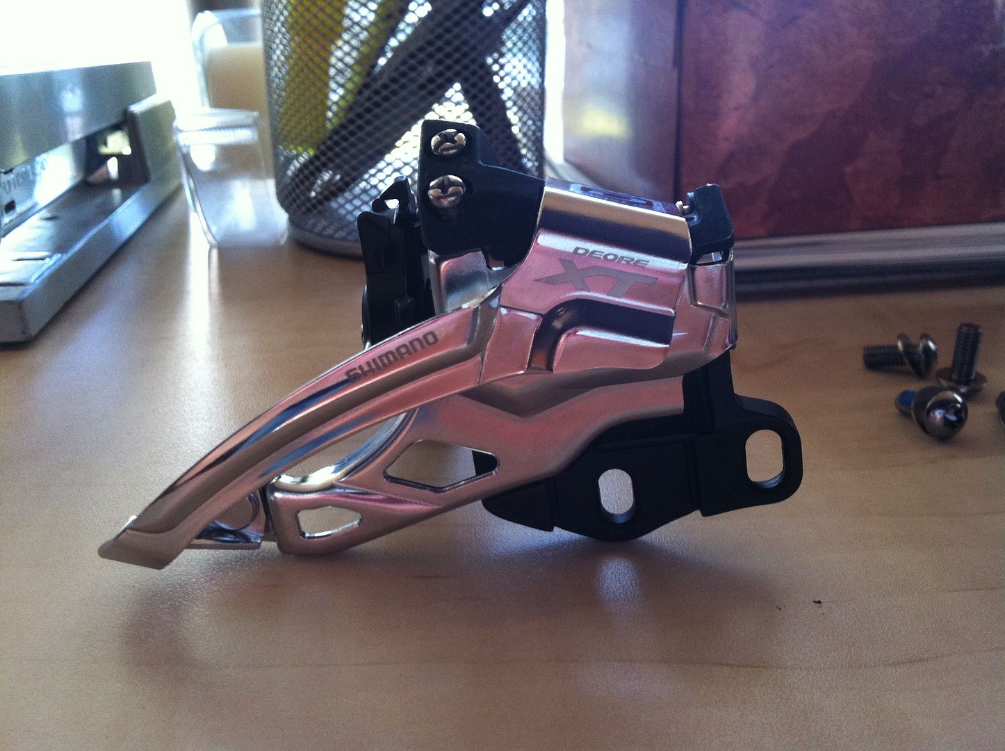

    I think I need some help. I might have ordered the wrong front derailleur or I just don't see how it fits on the Butcher.
    " width="549">
    Sorry for the iPhone pix...

    Quote Originally Posted by roxo56 View Post
    Wrong one, it's a direct mount. You want a regular ts/tp.
    "The Butcher uses a 34.9 top swing/top pull front derailleur. Pretty much anything from SRAM or Shimano that meets these guidelines will work (not Saint)."
    Might help:
