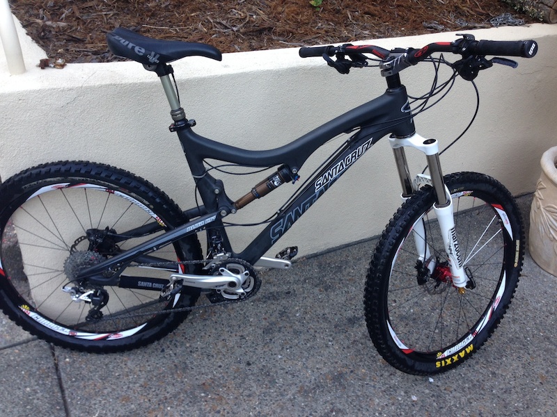

    I bought a large Blur LTC back in December during the SC sale, and I just haven't been able to get comfortable on it. I'm at the point where I am thinking of swapping it out to something else, but I figured there's got to be a few alternatives before I take a hit on the frame and try another bike.
    My main problem with the frame, is that with a dropper post, I cannot get the seat low enough to where I am comfortable on the bike on anything remotely steep or rocky. I don't find the bike unstable at speed or too steep (HA) but rather I just can't get back on the bike.
    It looks like I could get away with cutting about 2-4mm off of the seat tube. Has anyone ever tried to do this? I think doing that in combination with a lower profile seat may enable me to be able to ride the bike somewhat normally.
    Currently, I am running a Marzocchi 44rc3 (150mm) up front, with the bars way up high. Has anyone started on a 150mm fork and gone up to a 160mm? How did this change the ride characteristics of the frame?
    Has anyone been in this situation before? Is it worth trying any of this or should I just sell the frame and pick up something else?
    Thanks for any thoughts.
    -Ryan

    I am already running a 50mm stem and a Command Post that is bottomed out onto the frame. My problem is that even with the seat slammed, I cannot get back on the bike without the seat hitting me in the ass when I am descending. I believe I have the shortest dropper post available atm, so there is nothing I can do about that, except ditching it for a standard post (Hence, my idea to cut down the seat tube a few mm, I do think it could make a difference).
    I don't really fell like I need the front end to be any higher than it currently is, rather I just need to figure out a way to get the seat lower. Maybe the bigger fork will indirectly help out with this as it slackens the bike out?
    I was hoping to hear from people who may have had a similar experience as me and what they did to fix it.
    Picture of the bike for reference:

    I am looking to win enduro races and it's kind of hard to do when you aren't comfortable on the bike. Ditching a dropper, also isn't really productive toward that goal. I am not made of money and I am looking for solutions, and hence started this thread.
    I think you aren't understanding my problem. I don't need a shorter dropper(as in 3 inches of rise instead of 4) but rather I want the seat lower than the frame will allow when the dropper is in the ldown position. The Specialized post will sit the lowest of all the droppers that I know of, so I don't think there is anything I can change on that front.

    In your picture it was rather clear to me that you have the seatpost inserted as far as it will go. Therefore, I was not certain if you found the full height too great for comfortable pedaling. That issue could definitely be solved by a shorter dropper post.
    However, I think you have clarified that you are unable to get comfortably behind the saddle when it's dropped all the way. Is that right? And if so... how is that possible? I realize that the saddle would still then not be as low as a dirt jump bike, but just looking at your original pic I can only conclude what others have already said: if you can't get behind the saddle comfortably when it's fully dropped, you need a shorter stem.
    I do realize that when the post is fully extended and you're pedaling like hell that the stem length matters too. But since no one makes a stem that can be collapsed and extended while riding, you'll just have to find a happy medium.

    I understand your problem, I just don't see how it's possible by looking at the photo unless you have really stumpy legs or really poor technique.
    Thoughts: thinner seat, push it a touch forward on the rails and angle the nose higher if you can tolerate it.

    Paul11y: Thanks for your thoughts. I may give a shorter shock a try. I should be able to find a used one relatively cheap. I'm not really too concerned, at this point at least, with how the bike climbs.
    Colin: I'm already using a 50mm stem. Funn makes a 45mm stem. I'll give that a shot if I can verify that or something else is actually shorter.
    DHbike8: Do you have a link to the offset bushings you used? I have already ordered a lower profile seat.
    Blatant: I can't move the seat any further forward. I guess I have a weirdly proportioned body. Technique isn't the problem.
    Thanks ya'll!
