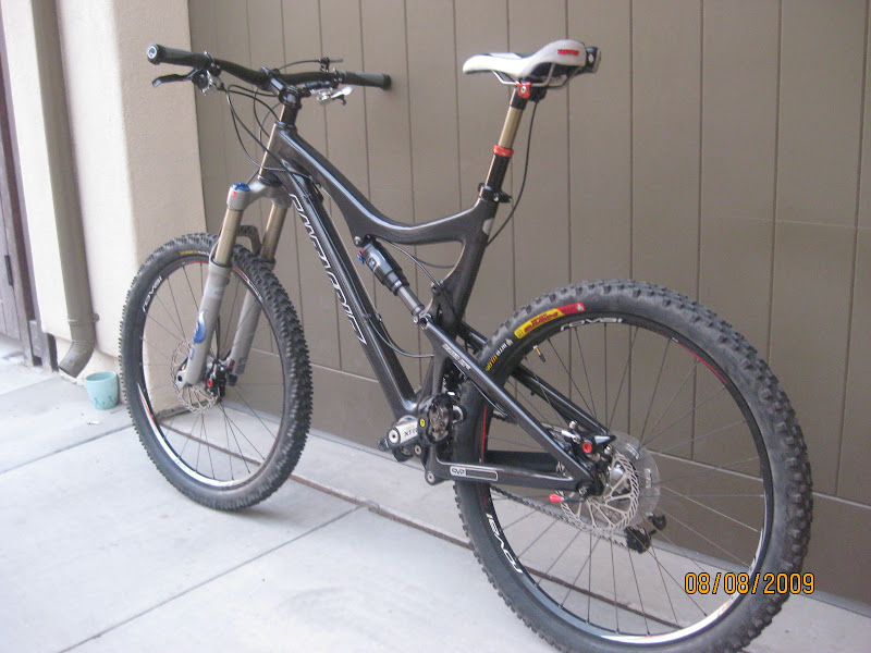

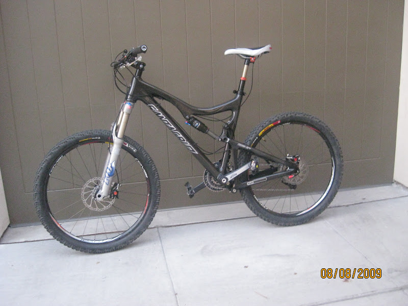

  • 05-29-2009
    m_driscoll
    5 Attachment(s)
    Here's the final 'build' and photos. Thanks Veloce Velo in Issaquah.
    Also took my first ride today. Spent a few hours at Paradise Valley (http://evergreenmtb.org/wiki/index.p...radise_Valley). Great place to try the bike out.
    Most of my time was with the fork at 130mm. 160mm was overkill. Still need to get the suspension 'dialed in'; especially rebound. You could definitely feel the differences in handling with the fork travel adjust. On the really tight singletrack in the 'bike park' (don't think Whistler) section, the 130mm felt good and the 160mm was hard to control. The 160mm will have to wait for another place. Set the RP23 for 17mm sag and didn't touch the propedal. Also, didn't use the Joplin.
    At 29.16 lbs., it's not my lightest bike; but, I didn't really notice. Climbing was controlled and smooth at 130mm (at 160mm, it was harder to 'weight' the front end). Descending felt very stable. I need to ride a trail a few times to get a better feel for the bike's performance as opposed to my own! So far - terrific, very fun bike, that's going to push my riding!
    Frame: Santa Cruz Blur LT Carbon, medium
    Rear Shock: Fox Float RP23
    Fork: Fox 36 Talas FIT RC2, 1.5 taper (4.98 lbs.)
    Saddle: WTB Devo Carbon
    Seatpost: Crank Brothers Joplin R, 30.9 (1.18 lbs.)
    Seatpost Clamp: Santa Cruz
    Handlebar: Easton MonkeyLite XC, High Rise, 685mm
    Stem: Syntace F-119 MTB, w/TI bolts, 90mm
    Grips: Ergon GE1
    Headset: Cane Creek Frustum ZS-3
    Shift Levers: SRAM X.0, trigger
    Front Derailleur: Shimano XT M771 Direct Mount
    Rear Derailleur: SRAM X.0, long cage
    Derailleur Cables: Gore Ride-On Sealed
    Brakes: Magura Marta SL Magnesium
    Brake Rotors: Magura SL Drilled, 180mm F & R
    Crankset: Shimano XTR Hollowtech II Crankset FC-M970, 175mm
    Chain: SRAM PC-991 Hollow Pin
    Pedals: Crank Brothers Mallet 3, Aluminum + Ti (0.97 lbs.)
    Cassette: Shimano XTR Cassette CS-M970, 11-34t
    Wheels: Industry Nine Enduro Flow (Stanís Flow rims)
    Tires: Continental Mountain King Protection 2.4 in., converted to tubeless (Stanís)

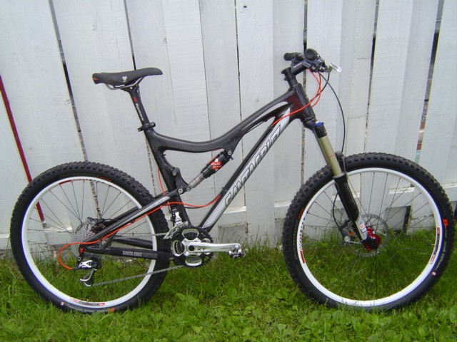

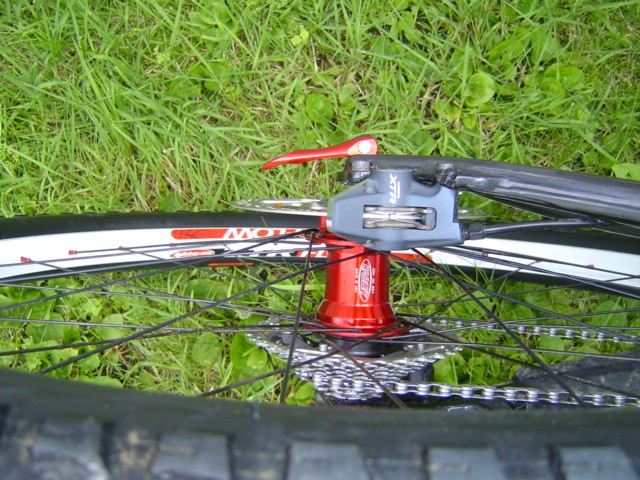

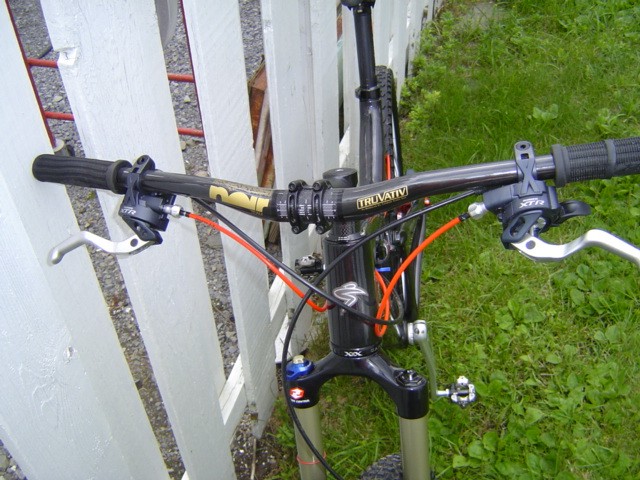

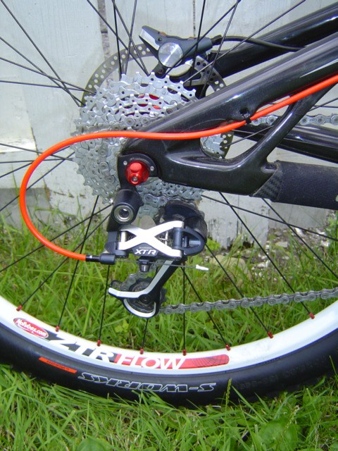

    I've finally finished the build of my LTc. It's torrential rain outside (again), so here are some interior pics for now. Oh, and yes, shortening the dropper post cable outer is on my list ;).
    Frame: Santa Cruz Blur LT Carbon, large (black/silver)
    Rear Shock: 2010 Fox Float RP23
    Fork: Rock Shox Revelation 140mm Dual Air U-Turn Maxle light
    Saddle: WTB Rocket V Stealth
    Seatpost: PureRace Cobra i900 Remote
    Handlebar: Easton MonkeyLite XC, Low Rise, 685mm
    Stem: Thomson X4, 90mm 0 deg
    Grips: ODI lock-on (Rogue)
    Headset: Hope
    Brakes: Hope Mono M4 183/205 w/ floating rotors & Goodridge hoses
    Chain: SRAM PC-991
    Pedals: Time Atac XS Carbon (arriving tomorrow!)
    Cassette: Sram PG-990, 11-34t
    Wheelset: Mavic Crossmax SX
    Tires: Maxxis Advantage 2.1
    Tubes: Specialized
    Weight: 28.7 lbs (I'll update this when the new pedals arrive...should drop a few ounces)
    Check out the lovely carbon reflections...

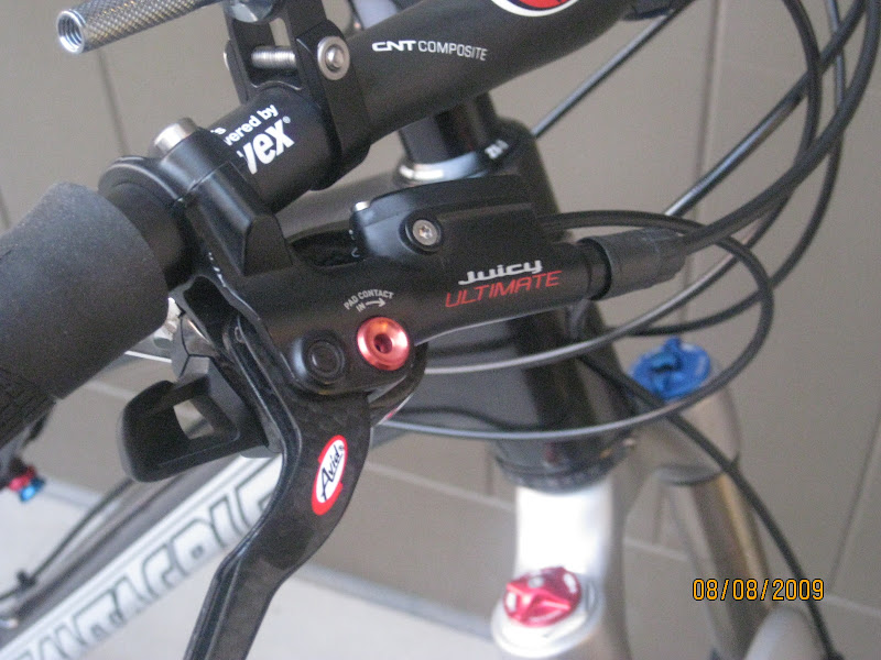

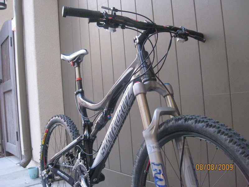

    massiveattack

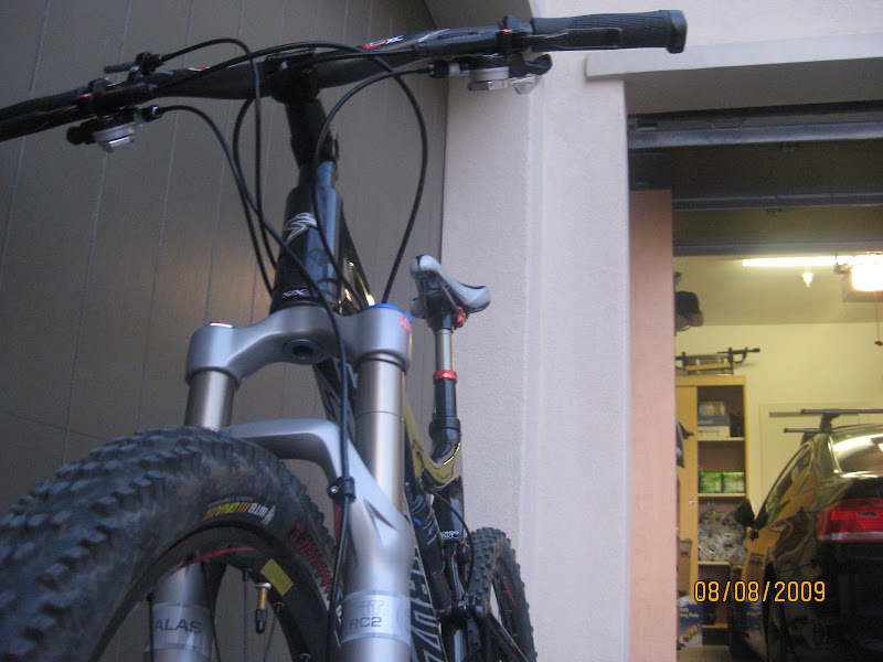

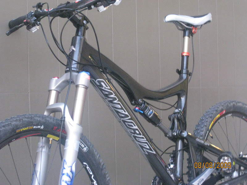

    my blur lt carbon setup....
    keeping with the theme of the thread...
    Fork: Fox RC 160
    Saddle: 2009 WTB Rocket V SLT Saddle
    Seatpost: 2009 Crank Brothers Joplin R Seatpost
    Handlebar: 2009 Easton Monkeylite XC Handlebar
    Stem: Thomson X4, 90mm 10 deg
    Grips: 2009 Ergon GE1 Enduro Grip
    Headset: Cane Creek
    Shift Levers: XTR
    Front Derailleur: XT M771 Direct Mount
    Brakes: Avid Ultimate
    Crankset: XTR Hollowtech II Crankset FC-M970, 175mm
    Chain: XT
    Pedals: 2009 Shimano PD-M424 Pedals
    Cassette: TXTR 11-34t
    Wheelset: Roval Traversťe Trail, disc Wheelset
    Tires: WTB Weirwolves (f) Mutano (r)
    Tubes: Tubless...
    Weight = 28.4
    Here's my new blur lt carbon, which i traded my s-works enduro sl for...
  • 08-08-2009
    invol2ver
    how does it ride with the 160 on it? also how does it compare to your enduro?

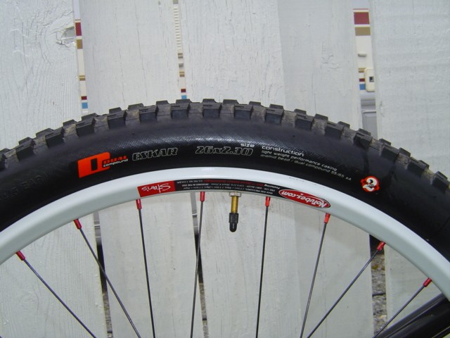

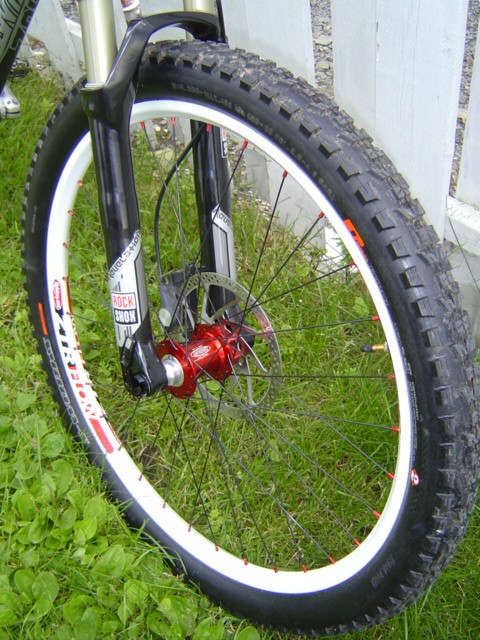

    Here's my new Blur LTc.
    This bike replace my old faithfull '03 original Blur. So far the learning curve is a little bumpy and i miss the stellar climping ability of my older blur. I want to try new lighter tire and rim to pinch out more performance out of this otherwise great bike.
    I just receive ZTR arch rim to replace the current ZTR flow on the bike. For tires, i'm thinking about narrower Hutchinson Toro 2.1 Tubeless Ready.
    Frame Santa Cruz Blur LTc Large
    Rear shock Rock Shox Monarch
    Fourche 2010 Rock Shox Revelation with maxle lite axle and Taper headtube
    Headset Cane Creek XX taper (custom made for Santa Cruz)
    Stem Syntace F119 90mm
    Handlebar Truvativ Noir Team
    Brake levers Shimano XTR dual control
    Shift levers Shimano XTR dual control
    Frt derailleur Shimano XT direct mount
    Rr derailleur Shimano XTR Low normal
    Gear Cable Jagwire Ripcord
    Saddle WTB Rocket V race with titanium rail
    Seatpost Syntace P6
    Crankset Shimano XT
    Pedals Shimano XT
    Cassette Shimano XT
    Chain Shimano XTR
    Frt hub Hadley 20mm convertible
    Rr hub Hadley with titanium cassette body and optional 72 pt engagement
    Spokes DT Swiss supercomp
    Nipplies DT Swiss red anodised (aluminum)
    Rims Stan's ZTR Flow white
    Tires Specialized S-work Eskar 2.3 2Bliss
