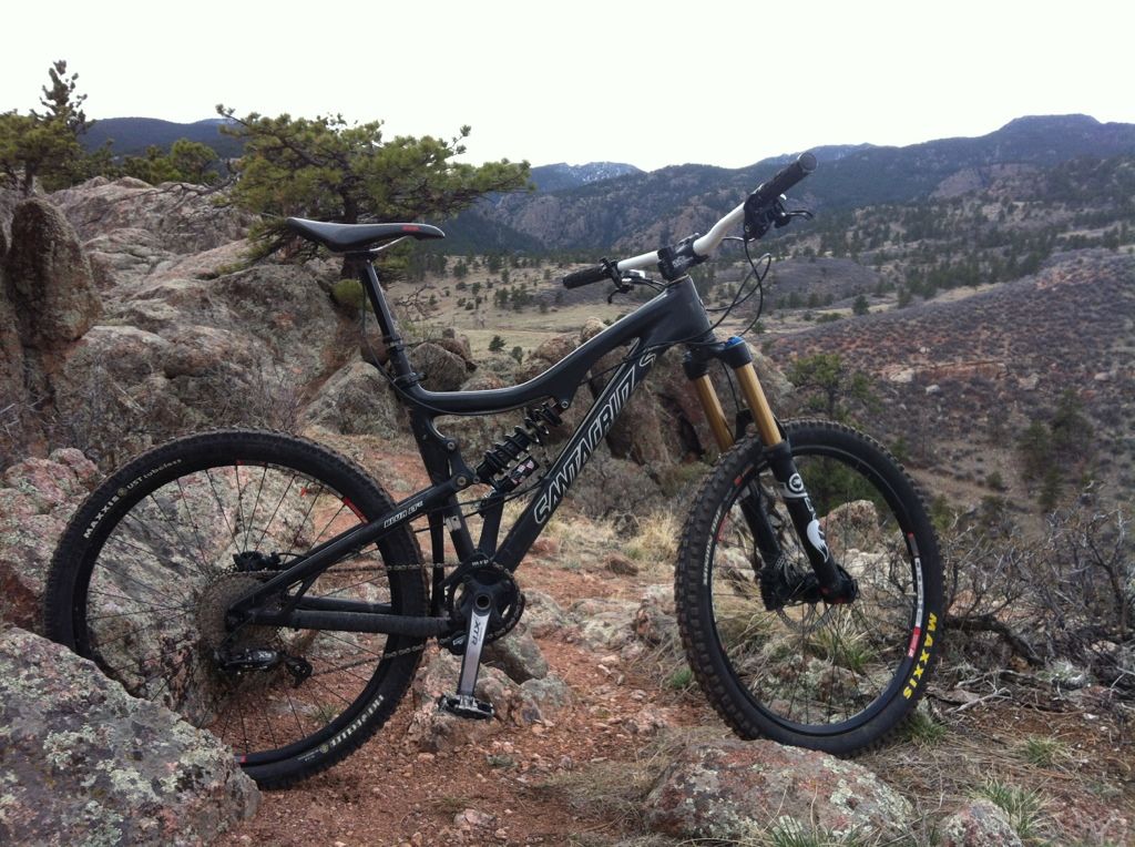

  7. #907
    Don't ride a Trek anymore
    389
    <a href="http://s630.photobucket.com/user/ibanezplayer470/media/E320AC9E-57A2-4171-8463-4E354B6B2507-32935-0000255A293C5F6F_zps00c75c06.jpg.html" target="_blank"><img src="http://i630.photobucket.com/albums/uu24/ibanezplayer470/E320AC9E-57A2-4171-8463-4E354B6B2507-32935-0000255A293C5F6F_zps00c75c06.jpg" border="0" alt=" photo E320AC9E-57A2-4171-8463-4E354B6B2507-32935-0000255A293C5F6F_zps00c75c06.jpg"/></a>
    Among the custom tidbits are
    -Fox 36 Float @ 150mm
    -Rock Shox Vivid RC2 350# spring
    -RWC Needle bearings
    -Angleset at -1*
    -Tubeless EX500 wheelset, 2.35 UST High Roller rear/2.5 Exo Minion DHF front
    -x9 1x10 drivetrain with MRP G2 Mini guide
    -785mm Funn Fatboy DH bars with a 60mm Raceface stem
    Waiting on some offset shock hardware for the front mount to lower the BB and rake it out a bit more. This bike is a beast as a pedal-anywhere freeride/enduro/trail rig!

    Quote Originally Posted by Trek7000rider View Post
    -Angleset at -1*
    I think this is the first BLTc I've seen with a coil. How does it ride? Are you riding the bike parks with this thing?
    389
    Quote Originally Posted by SoWal_MTBer View Post
    I ride this bike on pretty much everything. I have a downhill bike for racing and the really hairy stuff, but this thing is my go to fun bike. I love doing dh runs with it, but it still pedals well enough for xc/enduro type stuff
    The coil is a lot better than the rp23 for me. I had problems getting the rp to feel good over chatter and bumps but still have enough support for big hits. It either felt harsh or wallowy. With the coil, I have better small bump compliance as well as enough support for deeper in the travel. It still pedals well too

    * Frame Size, Color & Shock: Santa Cruz Blur LTc, Large, Matte Black / Fox Float CTD Kashima
    * Fork: Fox 32 Float 150 RLC FIT 15QR Kashima
    * Brake, Front: Hope M4 183mm w/ floating rotors
    * Brake, Rear: Hope X2 160mm w/ floating rotors
    * Cranks: SRAM X.0 175mm w/ 34t MRP Bling Ring
    * Front Guide: E.13 XCX / Bionicon C-Guide
    * Rear Derailleur: SRAM X-9 Type 2
    * Shifter: Rear SRAM X.0 10 Speed
    * Pedals: Crank Bros. Candy 3
    * Stem: Thompson X4 90mm
    * Handlebar: Race Face SixC
    * Seatpost: KS LEV 125mm 30.9
    * Saddle: WTB Pure V
    * Bottom Bracket: Truvative GXP
    * Cassette: SRAM PG-1050, 11-36
    * Chain: SRAM PC-1051
    * Headset: Cane Creek 110 ZS Top 44mm / Bottom 49mm
    * Grips: ODI Rogue
    * Front Tire: Specialized Eskar2 2.3
    * Front Rim: Stan’s ZTR Flow
    * Front Hub/Skewer: Hadley 15mm
    * Rear Tire: Specialized Eskar 2.3
    * Rear Rim: Stan’s ZTR Flow
    * Rear Hub/Skewer: Hadley 10mm Bolt
    * Weight: 28ish?
    Blur LT Carbon Setup Thread-imag0640c.jpgBlur LT Carbon Setup Thread-dsc02361c.jpgBlur LT Carbon Setup Thread-dsc02362a.jpgBlur LT Carbon Setup Thread-dsc02359c.jpgBlur LT Carbon Setup Thread-dsc02366c.jpgBlur LT Carbon Setup Thread-dsc02364c.jpgBlur LT Carbon Setup Thread-dsc02370c.jpg
