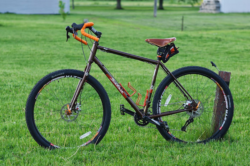

    which handlebar is this?

    Quote Originally Posted by lee paolo View Post
    Paolo
    Looks like the On-One Midge bars.

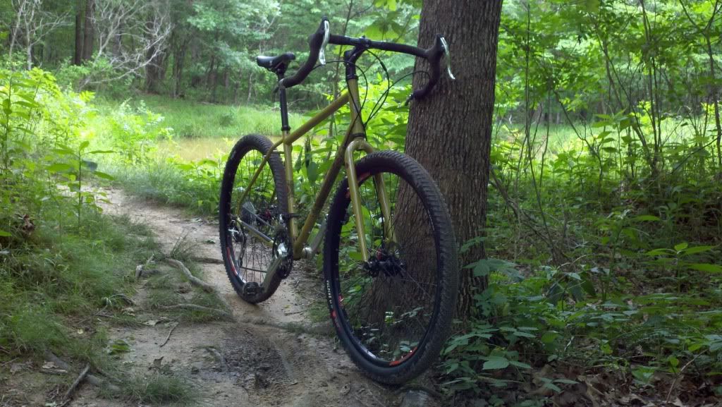

    Nope! I posted that image. It's a Ti Fargo I built up for a customer of the shop where I work at that is doing Tour Divide in a couple of weeks. That bar is Ragley Luxy Bar. No longer available. You could only get those from Chain Reaction Cycles U.K.
    There must be some sort of world wide synergistic convergence for these bars. This is the third time today I've seen or been asked directly about them. I've had mine for several years and had no inquiries until today. Weird!

    89
    Quote Originally Posted by Doug_ID View Post
    I have been running Marthon XR's and now the new Mondial for quite a while. I run them tubeless at 35-40 psi. They are almost bullet proof and last forever.
    What size are they? 40c? looks like you have plenty of clearance all around. thinking of using 40-50 Duremes
  38. #3238
    Spud State Rider
    Reputation: Doug_ID's Avatar
    602
    Quote Originally Posted by nachtjager View Post
    Yea they are
    700 x 40c
    I had been running the 50's before and decided to try something a bit narrower. Thinking now a 45 or so would be perfect.

    Picked up my brand new 2013 Fargo 2 XL yesterday! What a beauty, rides like a dream. I stuck with the brown/orange theme for some accessories. Still waiting on the Wanderlust rear rack so I can mount the brown/orange pannier
    Taking it out for its first long ride today, really looking forward to it.
    As for the LBS where I bought it, I'm a bit disappointed. Seems like I overpaid for the bike ($1950 +tax, most other places have it at $1850). And the brakes were VERY poorly adjusted, making it hard to come to a complete stop at all. I spent all of 5 minutes rectifying that, not sure why the LBS didn't do it.
    Speaking of brakes, even adjusted to perfection, they're still underwhelming. I've been running hydraulic Avid Code 5's with a front 203mm disc for the last 3 years, and going back to BB brakes with a 160mm disc takes a lot of getting used to. Maybe I'll dig into my spare parts bin and see if I can find a bigger rotor and caliper bracket.

  42. #3242
    132
    There, that's better:
    I ordered a proper IS 203mm caliper bracket, but for now the post-bracket-on-IS-bracket setup works fine. Still doesn't stop near as well as my Code 5's, but it's a vast improvement over the 160mm disc. Now the rear looks puny, and I can't lock it up... maybe I should upgrade it to a 185mm
    Quote Originally Posted by fox1965 View Post
    Goreman, how tall are you? I like your XL - not too many spacer and not too much seatpost sticking out. It looks nicely balanced. What pedals are you using? Some SPD freeride? They are wide! Enjoy your maiden voyage on Fargo!
    I'm 6'1", with a relatively short inseam (so long torso). The saddle height needs to come up just a smidge, but the fit is otherwise perfect, exactly what I was hoping for.
    The pedals are Wellgo WAM-D10's. They're a double-sided pedal, platform on one side and SPD on the other. I've been running WAM-D10's for 4+ years, and I never want to switch. I replace them with the same model when they wear out (about every 2 years so far). They're amazingly convenient. You can tell which side of the pedal you're stepping on by feel, so if you're on the wrong side, you just lift your foot off the pedal for half a turn and put it back down. I wear my SPD shoes for long treks, and I can hop on with any normal shoes for short runs to the mailbox or the convenience store. These work way better for me than typical platform SPD pedals.
