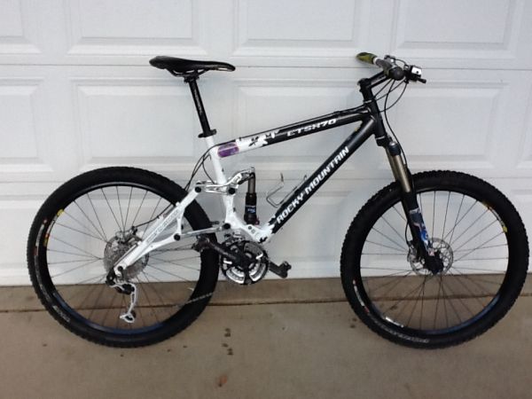

    After your post and researching more, I'm not sure what year this is. Here is a picture for your enjoyment.
    Since it doesn't have a carbon rear triangle I guess it couldn't be a 2008. It must be earlier. Just wondering If you can tell what year it is and if you think it would be good for a few years if its in good condition for well under a grand.

    I'd say from the paint scheme that's likely a very late 2008 ETS-X70 and they likely ran out of carbon rear swingarms. 2008 was the last year of production and this was one of the last of the Canadian made frames, so they were able to continue building the alloy rear swingarm for production bikes.
    BikePedia - 2008 Rocky Mountain ETSX 70 Complete Bicycle
    Even the 2007 ETS-X70 had the carbon rear swingarm...
    BikePedia - 2007 Rocky Mountain ETSX 70 Complete Bicycle
    Under $1000 is a good deal as you can't get much of anything beyond entry level for that kind of money. Even if you had to spend a couple of hundred bucks on fork/shock rebuild in the first few months that's still a bargain. The frame only price was about $2400.

    Just got an e-mail from the owner. The frame was replaced under warrantee 3-4 years ago. The bike was a 2006 or 2007. I'm guessing that means the frame is an 08 with an older (probably 06 swingarm)??
    ups and downs
    Reputation: rockyuphill's Avatar
    Nov 2004
    13,100
    That's a definite possibility, 2005 and later used the same style of alloy swingarm and the longer shock and suspension link. The newer front triangles were much less prone to cracking (nothing on a bike is indestructible). If you are able to look at it in person, the places that cracks happened tended to be around the pivots where they were welded to the seat tube, and they are usually very visible as cracks through the paint.

    Well I picked it up. From looking at the serial # it looks like the main triangle is an 2008. The bike looked to be in good condition except for a ding near the top of the downtube. Its a weird place for a ding. The shock and forks look to be in good condition, no cracks in frame, wheels are true, Thompson elite seat post, Easton carbon bars. The pivot bearings seem good. I'm going to tear it down and lube everything. Probably rebuild the forks and shock.
    Here are some pics.
    It looks like its been ridden, but taken care of.
    Got it for less than 700 USD
