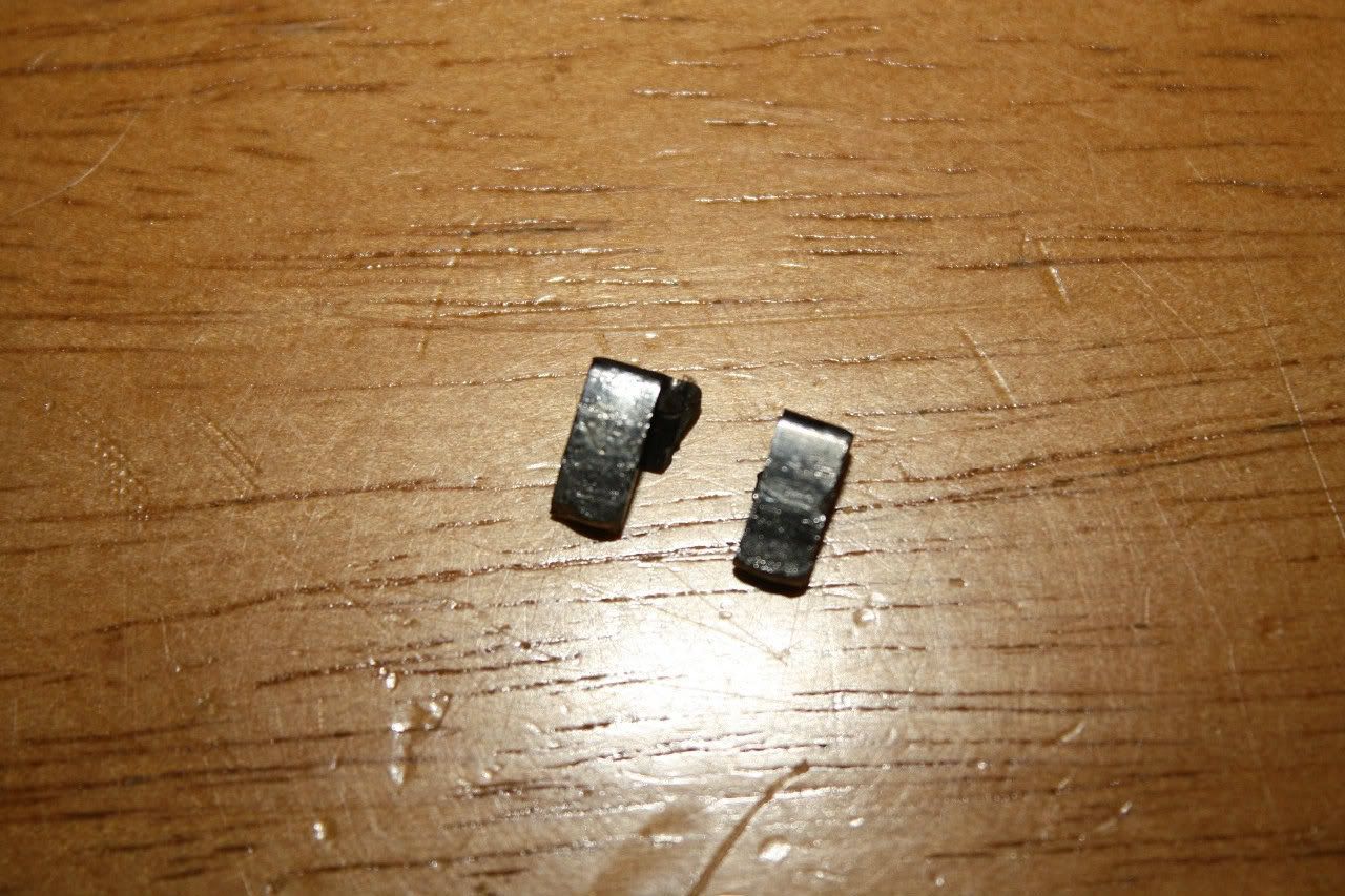

    Rear DT swiss 370 busted
    I need a bit of help here and I don't know where to post about it since I don't know if Rocky can help or not with hub spare parts?...
    One pawl snapped in two this morning
    And there's quite a lot of damage in the freehub dents
    So I would need a new pair of pawls, a new freehub and a spring while we're at it. The problem is : where do I get those parts? It is a DT Swiss 370 135mm Disk brake HUB used in rear wheels for Altitude RSL 2011. I found one site that would sell spare parts but it's in Germany or something... Basically it seems hard to find spare parts for this particular hub... I'm tight on money for a whole new hub so not an option.
    Is RMB able to help me on this one?

    That hub is the same as the Onyx and yes, those are the parts you need. I know, I've busted a few of them. Somewhat easy to repair but a pain when they leave you on a trail somewhere, coasting back to the car.
    Try Jenson for some of the parts. I have seen the parts there. Links:
    DT Swiss Onyx Pawls > Components > Wheel Goods > Hub Small Parts | Jenson USA Online Bike Shop
    DT Swiss Onyx Retainer Holder > Components > Wheel Goods > Hub Small Parts | Jenson USA Online Bike Shop
    For whatever reason, they don't list the outer shell as available but it is on ebay for about $50 DT/Onyx Steel Freehub Body on eBay!
    You might try calling Jenson and asking if they have the shell and could set you up with one order and shipment.
    One other idea is to ask your shop if they will contact DT Swiss in the USA and see if they will warranty the parts for you. If you have had the bike for about a year, they may just send you what you need, no cost. Worth a shot first.
