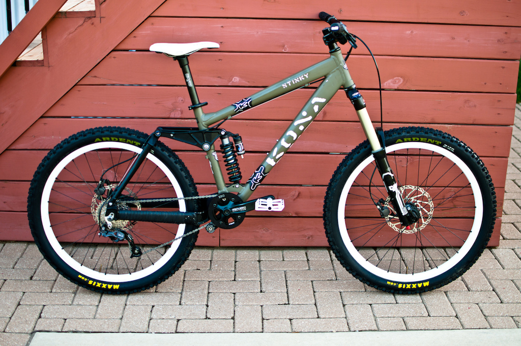

    This thread has definitely my interest. I'm slowly bike shopping for my brother to replace his Kona Stinky size XL (converted more to an all-mountain build) and he's 5'10, a junior in high school. The Kona has a 23.2" ETT, 66.5 HA, 72.5 SA.
    Looking at 18" ETT, the Slayer is 22.6", the 19" ETT is 23.4", and both with super steep SA of 75.
    His main complaint right now is the Stinky feels short and cramp, the saddle is pretty far back on the rails too, 50mm stem (and that's what he will be using). We tried a longer stem but felt awkward.
    Speaking from experience, my Kona Honzo also has slack HA, steep SA, and doesn't feel as big as the ETT and reach numbers suggest. I'm going to say it's due to both those factors.
    I'm thinking of possibly getting the 19" for him, the price is great for the Slayer 50.
    Although the Kona looks to be more roomy, go figure.
