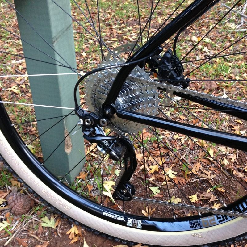

  • 07-18-2015

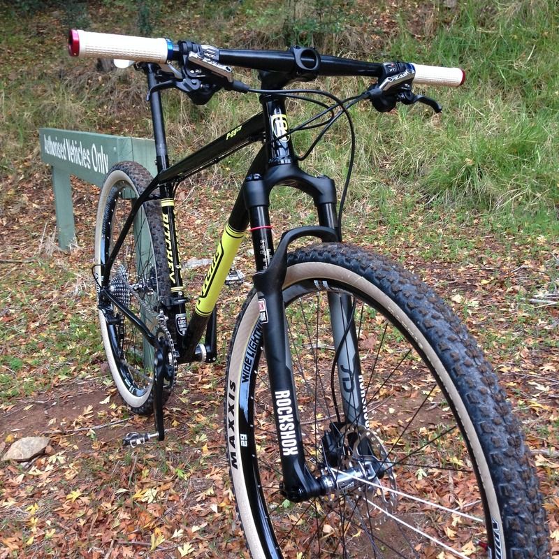

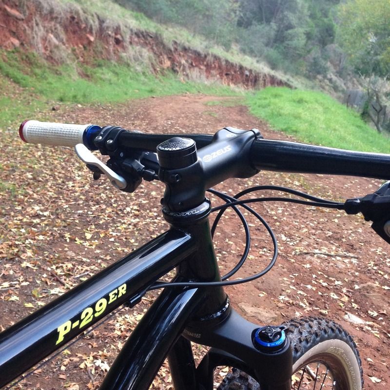

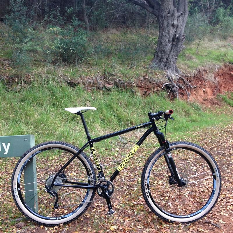

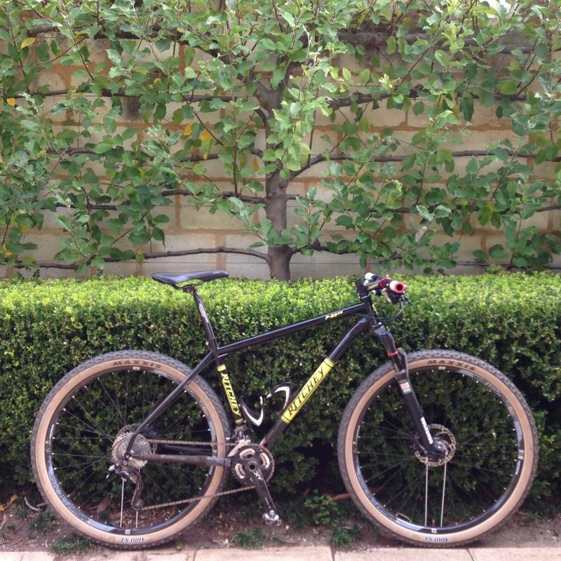

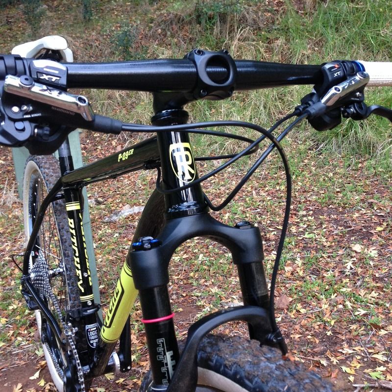

    drew-8888
    Hi All,
    built my v2 up a few months ago and its been put through its paces in a few races, local trails and the south australian flinders ranges
    What can I say, its brilliant.
    Bathroom scales says its around 11.3kg.
    2015 P29er V2 19"
    RockShox SID RCT3 100mm
    American Classic Wide Lightning
    Maxxis Ardent skinwall 29x2.25
    Shimano XT 2x10
    Ritchey carbon post
