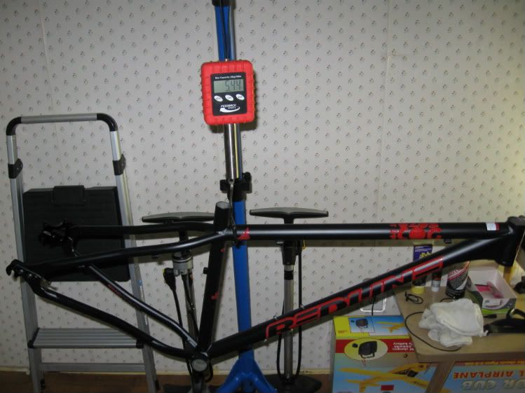

    Monocog Flight frame weight (size sm)
    I just picked up a 2011 Monocog Flight frame and should be starting my build soon. The frame (no headset or seatpost clamp just the frame itself) weighs 5.44lbs as is.
    Edit to include photo since I know we all love to see a pic..

    I have the same frame, but it is a large. It was also a warranty. I just recently noticed that the mounts on the down tube are not aligned correctly (the top mount is off center to the right) and are placed so that I cannot mount two water bottle cages (they overlap) . Of course this is not a huge problem, but it is really disappointing. Iíve been riding Redlines since I was a kid, and feel like their quality has diminished. I know that there can be problems with any bike, but my new frame is a warranty and it is not even right. At least the issue does not affect the ride which is pure awesome. I do plan to take it up to my LBS and see what they think. If I can get a new one sent while I keep this one then I may do that otherwise I will likely just live with it.
