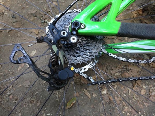

    MTB Pilot
    I finally converted the 429 to a 1x drive train with Wolftooth 42t cassette cog and 32t ring. After riding my LES and Carbine 29 as 1x, I just got sick of listening to the noise of the 2x and beside I rarely use the 26t ring in front. NO MORE FDs for me!!!:thumbsup: Took almost a pound off the bike, now sitting at 27lbs 13oz!:D
  • 06-10-2014
    SCR818
    ^How much clearance is there between the chain stay and the chain ring? Looks real close.
  • 06-10-2014
    MTB Pilot
    There is plenty of clearance, even for a 34t ring.
  • 06-10-2014
    SCR818
    Yes, I see now. Lots of clearance.
    Did you simply attach the chain ring to the big ring position on the crank? Or is there some sort of spacer used? How's the chain line when on the low gear (big/big) of the cassette?
    I'm asking because I have the same crank set (set up 2 ring) and the chain line is terrible when I'm in the big ring on the crank and on cassette.
    My frame is an '09 Mach 429.
  • 06-10-2014
    MTB Pilot
    Yeah, used the same bolts and attached to the 104BCD(big ring) part of the crank. The chain line is great, pretty neutral until the 11t and 42t; Even then it's not bad and will only be used a small percent of the time.
    Well the 429 and 429c are quite different, so I don't know how well it would work on your bike. That seems odd that the chain line is so bad on a 2x specific crank. On my LES, I had a 3x XTR crank that I used for my 1x set up with a Wolftooth 34t ring. I mounted the ring on the inside of the big ring positions and had to use spacers between the crank and ring due to the chain line being pretty bad. All good now though.
  • 06-10-2014
    SCR818
    If I were to use spacers to position a single ring (mounted in the 104BCD position) in between where the two chain rings are now, the chain line would be good. I am just a bit concerned about how close the single ring would be to the chain stay. As it is now, the 26 tooth small ring on my 2X crank is pretty darn close to the chain stay. A 32 tooth ring is exactly what I would want to use if I were to go in that direction.
    EDIT: Ooops! It's the big ring (38 tooth) that is uber close to the chain stay, so a 32 tooth would easily work in that position even if I used some spacers to bring it in a wee bit closer to the frame for a mid positioned chain line.

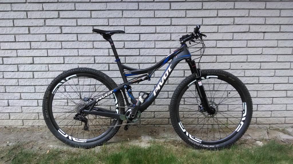

    Jeepnut22
    Latest thing I have done was to build it up and ride it!!
    5.7c, Medium
    Fox CTD Kashima
    Pike RCT3 Solo Air 150mm
    XO Cranks
    Wolftooth direct mount 32T Chain Ring
    Time ATAC Carbon pedals
    XO Type 2 Medium RD
    XO Shifter
    1070 cassette with the 11T removed and a Wolftooth 42T installed
    KMC Chain
    Thomson 90mm stem (Plan to swap out for a 70mm)
    ENVE Bars
    ESI Grips
    XTR Trail Brakes, 180/160 f/r
    Specialized Command Post Black Lite (Thomson Masterpiece pictured)
    Specialized Phenom SL Saddle
    I9 Torch Wheelset, 15mm front, 142x12 rear
    Trail King 2.4 tubeless up front
    Purgatory 2.35 tubeless out back
    Bar Fly 2 mount for Garmin
    27.00 lbs. exact (weighed with Command Post)
    I love this bike!! I'll get better pics soon...
    Attachment 902267Attachment 902268

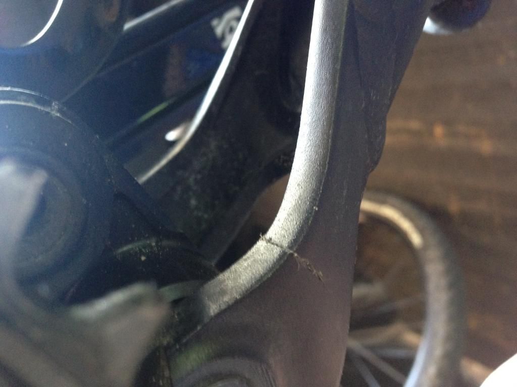

    WarBoom
    I washed it today!
    And found a crack!
    Been hearing a pop/creak noise while pedaling and it looks like I've found it
    Its on the milled section of frame behind the sprocket.
    Goes 3/4 of the way thru the piece
    Attachment 919193

    SCR818
    ^Brutal!!! Is there any warranty coverage in this case?
  • 08-28-2014
    snoroqc
    5.7 ??
  • 08-29-2014
    WarBoom
    Its a 2013 5.7
    And there better be warranty coverage!

    NOT saying it was or you did, but man it looks like someone tried to cut the frame! I've never seen a crack that perfect on aluminum before.
    You don't have an ex girl friend that wants you dead, do ya?
    Good Luck, but no need cause Pivot will take care of you.

    New frame complete is on the way don't even have to send in my old rear triangle.

    Ya, I really didn't have any doubts. Its just one of those freak things I bet.
