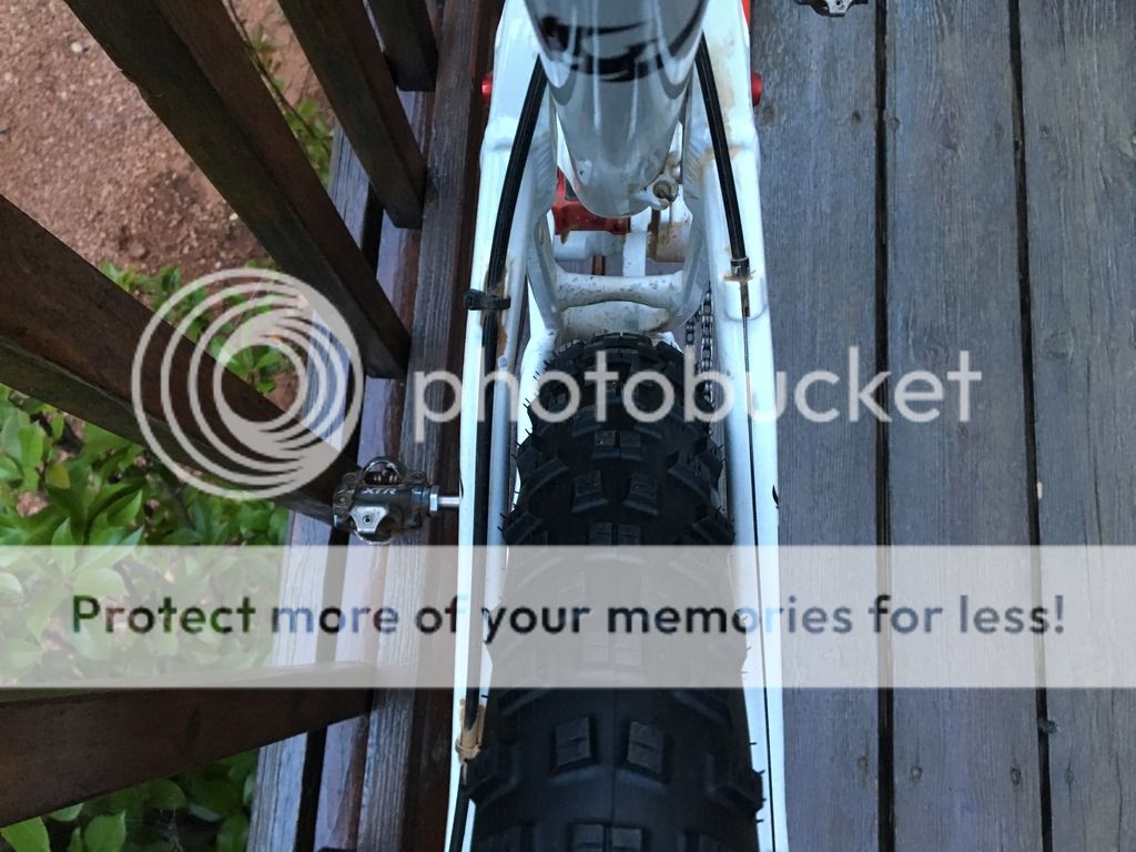

  • 05-29-2017
    AZ Stumpy
    Here's another 427. I bought a set of Race Face Turbine 30 wheels and a set of Nobby Nics in 27.5x2.6. Fits perfectly. The closest the tire comes to anything is the chain. I'm running XX1 and when I'm in the 42t cog there is only about 2 mm of clearance between the chain and the tire. I've put quite a few miles on it this weekend and the chain never hit the tire so it appears to be a non-issue. Not sure how a 2x10 setup would go though.
  • 05-30-2017
    Don Ticho
    429 with NN 27.5x2.8 on ARC30s no rubbing, excellent ride!

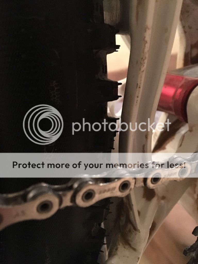

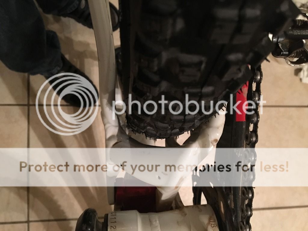

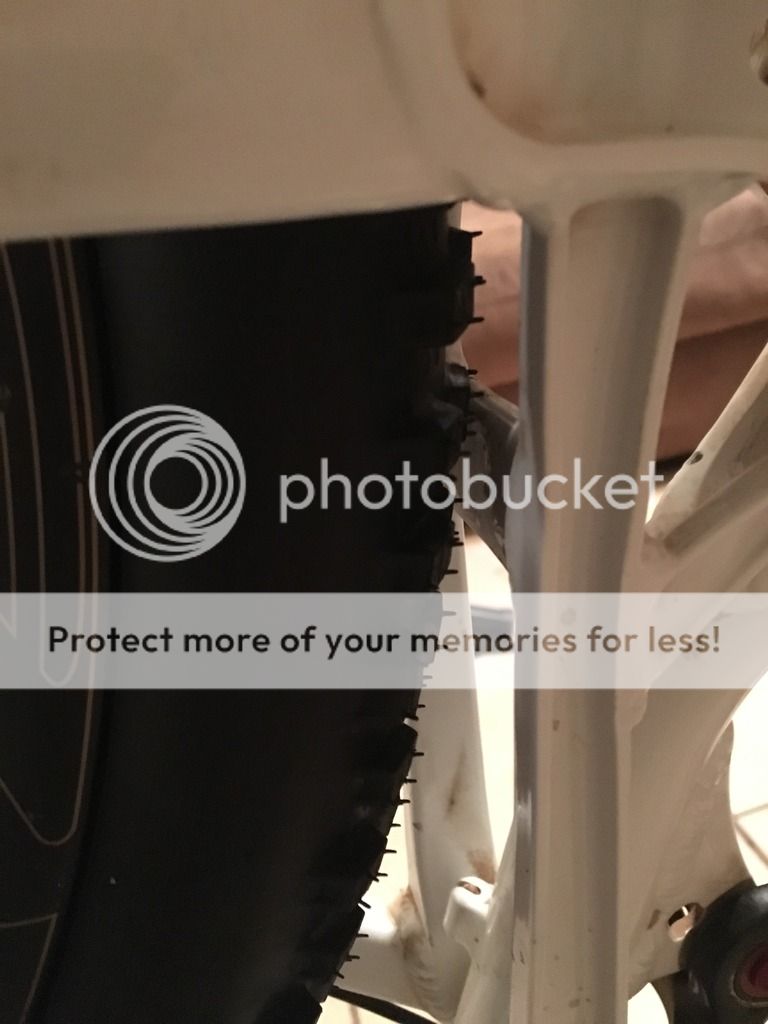

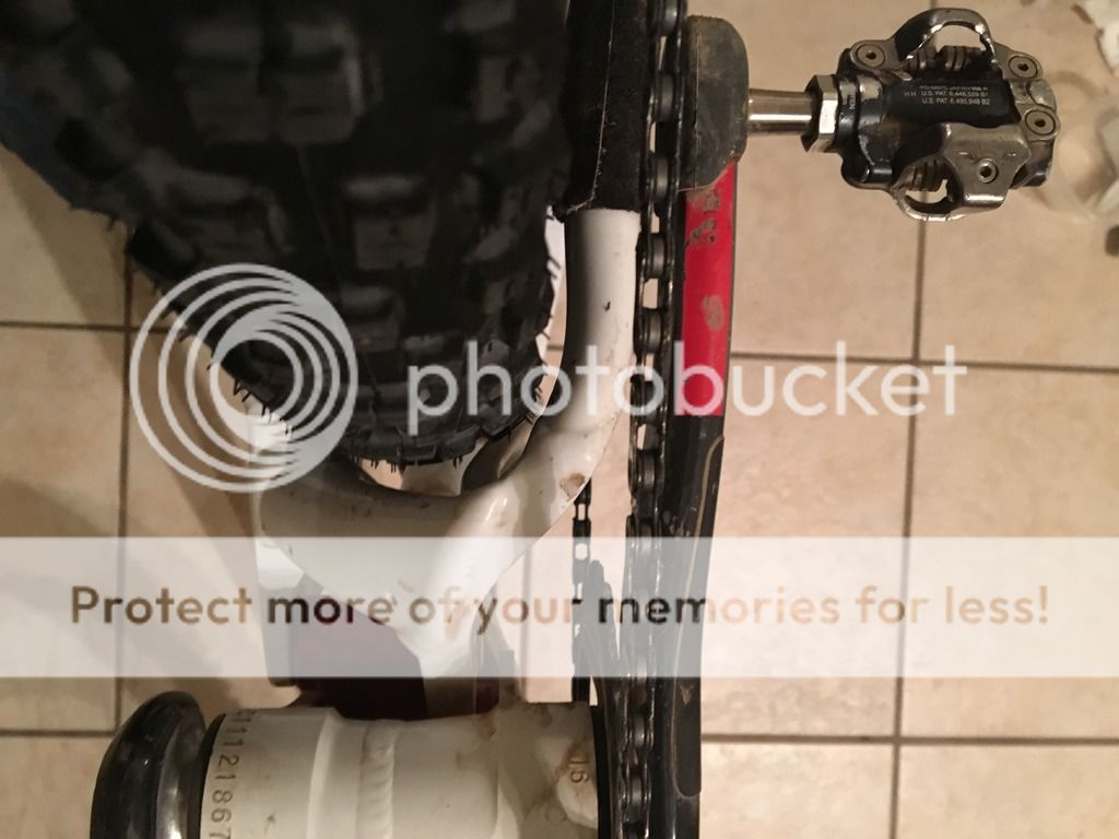

  • 04-17-2018
    nicja04
    427+? Now 2012 429A, Mezcal 2.25 tubeless fit by only 1mm. Thinking 27.5 plus, like Stans Baron i30 rim with Ikon+, Rekon+ 2.8s. Would love hear how other 427s have done!
