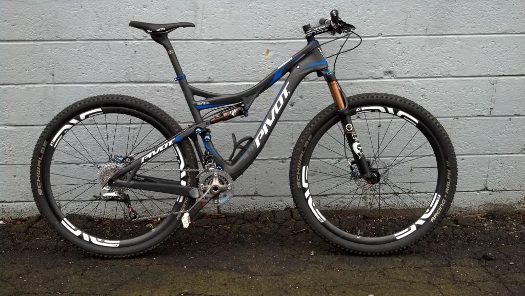

    bvader
    Serious Dude Night...
    Loving Wife out of town...
    Sci Fi on the Panel...
    New Pivot 429c Semi Custom Build In the House...literally
    Attachment 772248
    At this point I am seriously enamored with this bike...unbelievably capable and balanced, ruthlessly efficient and *very* fun transition and air capable. Rode Palm Canyon and the bike performed flawlessly. Setting PRs left and right...
    I have put ~100 Miles on it and changed out the 2x10 for a triple with a 22... more on that another time, but its the right choice for my riding habits.
    Trail Build...5.10" Medium , 70mm Stem (may go 90x10) XTR / XT mix, triple, 240s w Stans Arch ~27lbs.

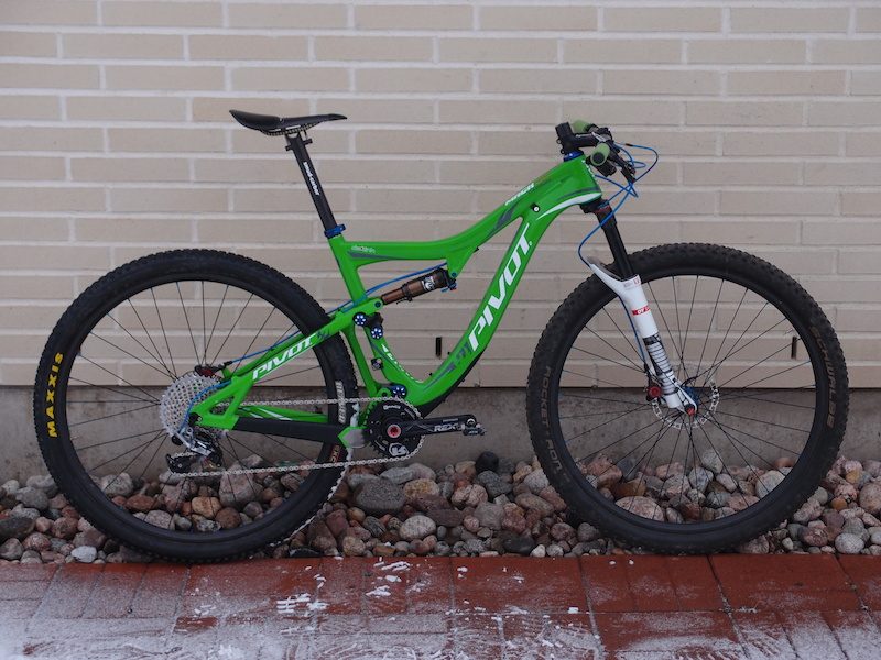

    Killrop
    This is my new build. Don't have it dialed in just yet (Need to cut the steer tube after I get some trail time in), been to busy at the shop. So far, looks good. Not a feather weight, but respectable at 24.5 lbs for a Large.

    Killrop
    I finally got a few rides in on the 429C. I am very pleased. My initial thoughts is it descends and corners better than any 29er I have been on. I am shocked how well it carves. I haven't got to test it on a hilly techy trail yet but I will on Thursday. Someone mentioned that it is very neutral. I would agree. It feels like a MTB should, be never does. I notice I clear sections much faster than before. Its almost like cheating. More to come...

  • 06-24-2013
    MTB Pilot
    Originally Posted by jaredbadams View Post
    Bike setup: Pivot 429C
    Frame Size & Color: XL Carbon/Blue
    Rear Shock: Fox CTD
    Fork: Fox 34 CTD 130mm
    Brakes: Formula The One
    Shifter: Sram XO
    Cranks: Shimano XT 175mm
    Chainrings: 22,32, Race Face bash
    Rear Derailleur: Sram XO
    Pedals: Shimano XT
    Stem: Thomson 90mm, 10 degree rise
    Handlebar: Sunline 745mm, 38mm rise
    Seatpost: Thomson
    Saddle: Specialized Phenom
    Bottom Bracket: Shimano
    Cassette: Sram 1070 11-32
    Headset: Chris King Inset
    Grips: ODI Ruffian MX
    Front Tire: Schwalbe Nobby Nic 2.35
    Front Rim: Stans Flow
    Front Hub: Chris King
    Rear Tire: Racing Ralph 2.25
    Rear Rim: Stans Flow
    Rear Hub: Chris King
    Rider: Twenty-years on mtb (6 on 29ers), former BMXer, based in Northern Virginia
    Weight: 220lbs
    Height: 6’4”
    Inseam: 36in
    Sleeve: 37in
    After last summer, I decided to put my six-year old Ventana El Rey out to pasture and update my ride based largely on geometry data due to a general lack of XL bikes to test ride. Having ridden a few bikes with shorter chain stays, I knew that I wanted stays shorter than the 18.3 ones on the El Rey, and I also was keen on finding a bike with a lower bottom bracket. After months of research, I pre-ordered the 429c from Competitive Cyclist in November and just took delivery of the frame the first week of April.
    Out of the box, I was incredibly impressed with how light the frame felt; easily a couple of pounds lighter than my El Rey. What didn’t impress me was the lack of internal cable routing, which I didn’t know was only featured on the smaller frames. Still, cable routing alone wouldn’t have swayed my decision and as I tell my four-year old, “You get what you get and don’t get upset about it.”
    The build was pretty straight forward as I was mostly porting over components from my older frame, and in hindsight, not having to fuss with internal routing, probably made the process a tiny bit easier. One thing that did stand out was the front derailleur; it was stupid simple to install. Who’s to say whether or not front derailleurs will be around in a few years, but while they are, direct mount is definitely the way to go.
    To date, I’ve only gotten in three solid rides on the 429, but I’m really loving it. There was initially some concern about choosing a 34 as opposed to a 32, fearing that it would rake the bike out too much, but that isn’t the case at all. Set at 130mm, the 34 brings the bottom bracket up to only 13.5in and slackens the head tube to about 69 degrees. This setup is spot on for the Mid Atlantic, where roots and rocks cause pedal strikes with lower bottom bracket heights, and, to boot, it feels very comfortable.
    There’s not a world of difference in terms of stiffness compared to my El Rey, but that frame is a tank in comparison, and I feel that the DW link suspension does provide much better pedaling efficiency. Looking down at the shock as I climb root and rock strewn trails, the back end gently absorbs and erases much of the harshness. And, when pedaling on the flats, there’s no discernible movement, even in the “trail” setting, which is where I’ve set both the shock and fork.
    Once I get more time on the bike, I’ll post a longer report, but thanks to everyone here for advice and build tips, and also to Pivot, who offered fantastic customer service throughout my wait. The 429c, so far, has been time and money very well spent.

  • 07-25-2013
    Xizor1
    Here is my 429 C- build: (L-size frame)
    Attachment 819050
    Fork: X-Fusion Trace RL2 120mm
    Wheels: DT Swiss 350, Stan's Arch EX, Supercomp
    Brakes: Formula R1
    Drivetrain: SRAM XX1
    Stem: Easton Haven 70mm
    Handlebar: Ritchey Trail Carbon 740 mm
    Seatpost: Reverb
    Seat: Selle Italia XP
    Tyres: Rocket Ron 2.25 with NoTubes sealant.
    Pedals: Shimano XTR
    24.7 lbs with pedals
    BTW, does anybody know can a 2.35" Hans Dampf or 2.4" Ardent be used at the rear? Looks quite tight with 2.25" already...

    Hi all and greetings from Finland!
    This is my first ever post to MTBR-forum. I just would like to share my great joy to have a new Xmas present purchased by myself.
    [/QUOTE]
    It has been built mainly for XC- and trailrides. The weight is about 10.4 kg (22.9 lbs).
    I have not yet even ridden it because we have nasty weather here up north. I prefer to save the enjoyment until the more pleasant weather comes in the spring.
    Currently I am doing all my winter rides with the full rigid On One Carbon 29 Racer using Schwalbe Ice Spiker Pro studded tires on Velocity Dually 45 mm rims - an interesting combo indeed!

    28.0 lbs 429C build
    Attachment 854008
    From the factory:
    2013 Pivot 429C size medium
    Fox Float 32 120mm travel CTD
    XT/XTR pro package
    Additions:
    Syntace W35 wheels
    Front Maxxis Ardent 2.4 tubeless
    Rear Racing Ralph 2.25 tubeless
    Ergon GP 1 bar ends
    Wellgo MG-1 pedals
    XT triple crank w/ bash guard 22/32 combo
    Total build weight with pedals 28lbs
    It seems heavy compared to most 429 builds, maybe if I put on the original wheel set it'd come in a tad less but loving those wider rims and bigger tires on the root and rocky stuff we have here.
