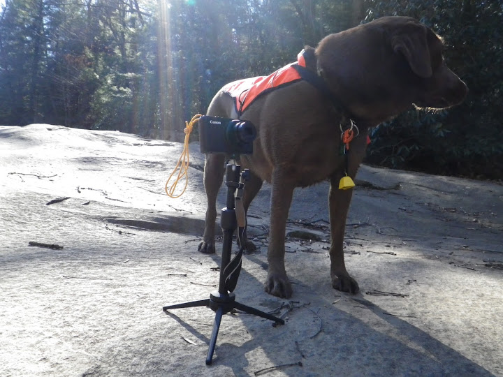

    1,604
    compact camera kit by mbeganyi, on Flickr
    My current setup. ZipShot tripod. Canon G12, speedlight 270 flash, vello wireless trigger.
