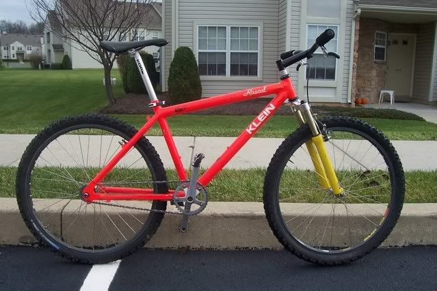

    Hi there,
    I live in S. Jersey & ride the local trails here, Wiss is pretty close to me as well...I'm just a few minutes from the Walt/Benny.
    Anyway...I'm thinking of dropping the gears (1x9 now) on my Chameleon & giving SS a shot. I'll be the first to admit I'm not a strong rider & find myself hiking here & there even with gears. But I like the idea of simplicty & trying to get stronger.
    Do you have any suggestions for gearing for a beginner single-speeding at the Wiss? I was thinking of just ordering a conversion kit & ss chain today. Already running a 32T chainring in front & would like to keep it if possible.
    Here's a pic of the lizard to get converted (couple minor changes since the pic...new seat & Hone cranks):
    Thanks in advance,
    Mark

    Got the lizard converted!
    Just got done turning the lizard into a singlespeed after running 1x9 for awhile. This will be my first venture into singlespeeding since riding BMX. Just took it for a spin around the neighborhood...man it's so much quieter, very smooth & feels a bit lighter.
    Stats:
    '05 Chameleon - medium
    Marz All Mountain 3 (130 mm) - hopefully replace soon
    Hone Crank - 32T - Sram PC58 chain w/ powerlink
    Azonic Outlaws w/ 2.4 MotoRaptors
    Thomson stem/post, Deity bars
    Hayes Mag (front), Formula Oro K24 (rear) (need a longer hose for the K24 front)
    Performance SS kit - starting out w/ a 20T rear cog
    Couple more pics:
    Right away I noticed my rear QR not holding so great. I have it cranked down tight & noticed some slippage. Gonna order the 10mm solid axle for the Outlaws. I tried using the derailleur inserts for the dropouts, but couldn't get the chain together. The rear disc lined up great & there's no rubbing.
    Hopefully soon I'm going to make some changes. I'd like to try a 90mm stem & lower riser bars (i.e. Syncros Bulk). Also, saving for a Pike & a custom (lighter) wheelset. I have M545 pedals to go on...but need some shoe's first.
    I think it'll be a fun bike for the Wiss & local Jersey trails. I'm sure it'll be hard at first, but I look forward to getting stronger. Besides that...I already find myself pushing the bike uphill with gears might as well just lose 'em & try it with one gear!
