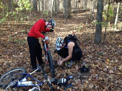

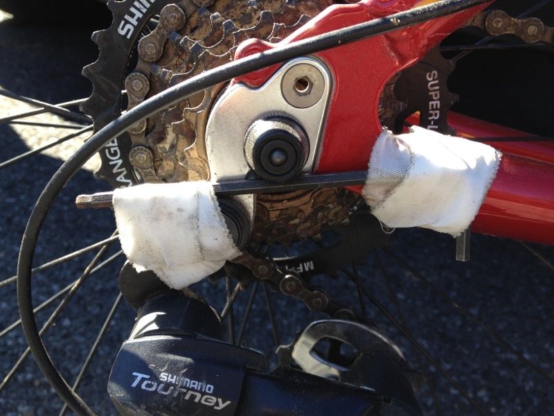

    So today I took a good friend out on his first mountain bike ride, it was a crisp, cool, and beautiful morning, and we started out great until... The rear derailleur hanger broke on the bike my friend had borrowed from his parents, the nub that keeps the arm from swinging forward and letting the tension off the chain was gone, and the chain wouldn't stay on the cog. He was extremely upset, thought he was going to have to walk back to the truck and that he had ruined the ride for the rest of us....not so, we fixed it with what we had in our packs!

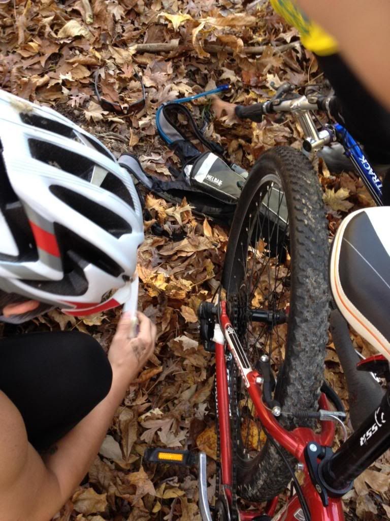

    so off to work we went
    And we came up with this
    which got us 8 miles back to the trailhead!
