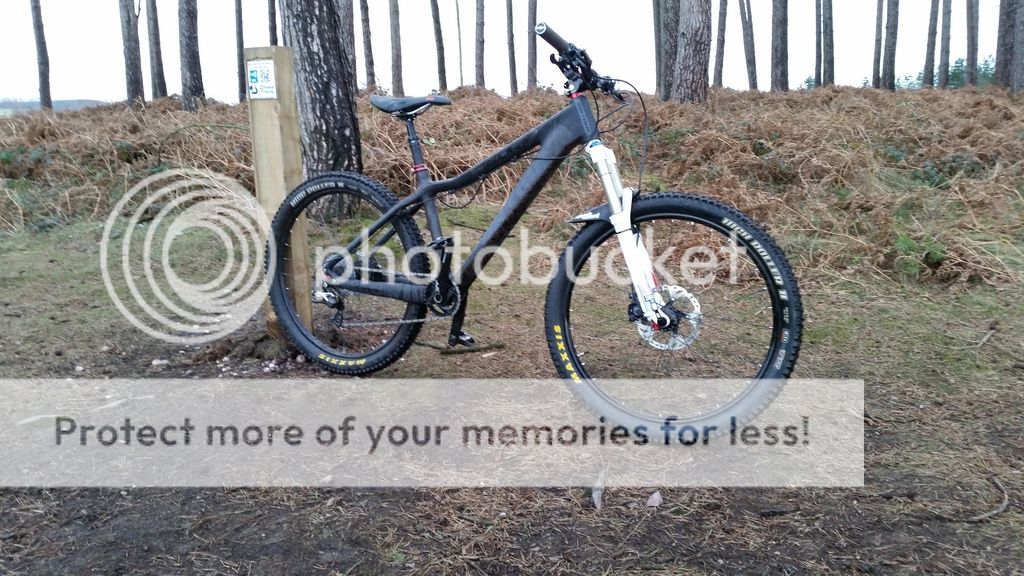

    here's mine, it's a 16".
    remember it's not always about having the shortest chainstays, longer ones offer more stability.
