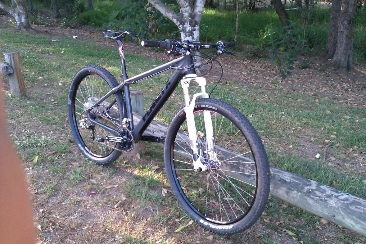

    After a year deliberating, I finally pulled the trigger and got one of the new (painted) frames.
    I'd been after something lighter than my current carbon frame (first gen Orbea Alma 29er), with shorter chainstays, steep HTA and short (tapered) headtube so that I could get my handlebars low (below saddle height) when running the forks at 100mm. I'd been running 80mm forks on my 29ers to quicken up the steering, but wanted the extra travel for rough races.
    Most of the components were transfered over from my Orbea:
    Frame: Dirty Harry (med)
    Fork: RockShox SID XX TA
    Brakes: Avid Elixir CR Mag
    Rear Mech: Sram X0 (9 speed)
    Front Mech: Sram XX
    Shifters: Grip Shift X0 (9 speed)
    Crank: Rotor XC2 W/ Q rings
    Bottom bracket: Chris King
    Chain: KMC 10SL
    Pedals: Speedplay Frog Stainless
    Saddle: Merek Carbon
    Seat post: Merek Carbon
    Bars: Ritchey WCS 10D
    Stem: Easton EA70 -20deg 80mm
    Grips: Roadie Bar Tape
    Rims: Stans 355
    Hubs: Chris King ISO
    Tires: Schwalbe Racing Ralph Snakeskin
    Not sure of the weight yet, I think around 10Kg. It feels light anyway.
    Compared to the Orbea, the shorter chainstays definitely help the rear wheel hook up on steep climbs. Also the Steering is as nimble (twitchy) as I wanted with the 100mm fork (I ride mostly tight & twisty trails). I think it will be a great race bike (have already got a few PBs on Strava).
    Don't flame me for the carbon saddle. I run these on all my bikes and have learned to love them, and actually find it more comfortable on hot humid days in Brisbane. I've also ridden on it through several marathons.
    Issues I have with the frame would be the lack of a chainsuck protector on the chainstay. I'd also have liked internal cable routing with a continous cable outer. I'm surprised that a frame designed in the UK doesn't have continuous cable outers (unlike my Scandal). I compensated for this by using Transfil Flying snake cables which use a full length tube between the inner and outer cables to keep the system sealed from the elements (like Gore cables). Would have been nice to see a BB92 on this frame also, though I was happy to not have to replace my chainset and BB
    Will post up again in a month or 2 when I've spent a bit more time on the frame.
    Alma 29, Reba Team, Chris King, Rotor 3D, Sram X0

    On my basic kitchen scales it came in at about 1220g. Wasn't too happy with that. I expect the paint added that much.
    Overall weight is 9.75kg (weighed on a luggage scale). From my previous build, I changed the frame and the forks (2009 Reba Team to SID XX) which saved me about 1/2 Kg. Very happy to get in under the 10 kg mark.
