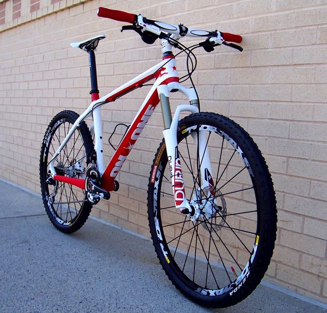

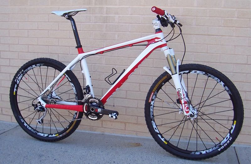

    My new On One Whippet
    I just finished building up my On One Whippet. The bike is very light (21.0lbs) and rides fantastic. I really wanted to say a big thank you to Michael at Planet X USA. First he helped me get the frame in the white/red color. They didn't have any in stock (just red and black) and he worked to get me a white and red one. When I got the frame the swap out bolts seized, so he quickly sent me another set. All I can say is great customer service, and a pleasure to deal with these guys. And now the pics of this awesome machine!

    Wow, I like it! Just ordered one myself, hope to build a light weight 650b'er

    Quote Originally Posted by ljsmith View Post
    Looks great, lj!

    ljsmith
    I remember you from a chinese carbon frame. (-: Can you shoot me a link to a front derailleur and bottom bracket that you are using? Most likely I will get Scandal but I might grab a whippet if my wife allows it.
    Bike looks really impressive.

    Yeah, I sold the Chinese carbon bike. The Whippet frame is much nicer and wasn't too much more expensive.
    Front derailleur
    Universal Cycles -- Shimano FD-M786 XT Direct Mount Front Derailleur
    Bottom Bracket(BB92)
    Universal Cycles -- Truvativ/SRAM GXP-BB86/92 Press Fit Bottom Bracket

    I have been a big fan of On-One bikes for a long time. I broke my chinese frame since I forgot to unclip. Yes, it still happens to me.
    Did apply anything when you installed bottom bracket? I read few posts and people mentioned creak problems.

    I applied grease to the cups of the BB. I was going to use a headset press to press it in, but it actually just slid right in when I pressed it hard with my hands, I was surprised. It is actually much easier to install and remove than an external threaded BB. I have no creaks or any issues with it at all.
    That is quite impressive. Did you buy the ceramic one? As far as I can there is aluminum "insert" so grease is safe. What do you think about running a 10 speed crank with 9 speed cassette. I do not think it is going o a problem.

    Cool bike! Got a Whippet myself
    Quick question, did you have to install a 1mm washer between the front mech and mount for the shimano xt to work properly? that's what the on one website suggests.

    I saw that also. When I first put the derailleur on, I could not see any reason why you would need to do this, so I didn't. However I took the derailleur off the other day and noticed a very small paint chip, maybe about 1mm, under where the derailleur mounts. So if you are concerned about that, then you probably would want to put the washer in. I didn't put one in and it works fine, and the paint chip is not visible when the derailleur is installed so I am not too concerned about it.

    I got the regular BB. I didn't see much value in the ceramic BB. You get a very small performance advantage from the ceramic, which probably is not noticeable unless you are a CAT 1 racer. They do last longer, but for the price you can buy about 5 regular BBs and I don't replace my BBs very often.

    ...and now, here you can see some pictures taken from my bike: (...and YES, my front tire mounted in the wrong direction, I know)

    Looks good. Have you had a chance to get it offroad? Hows it ride?
