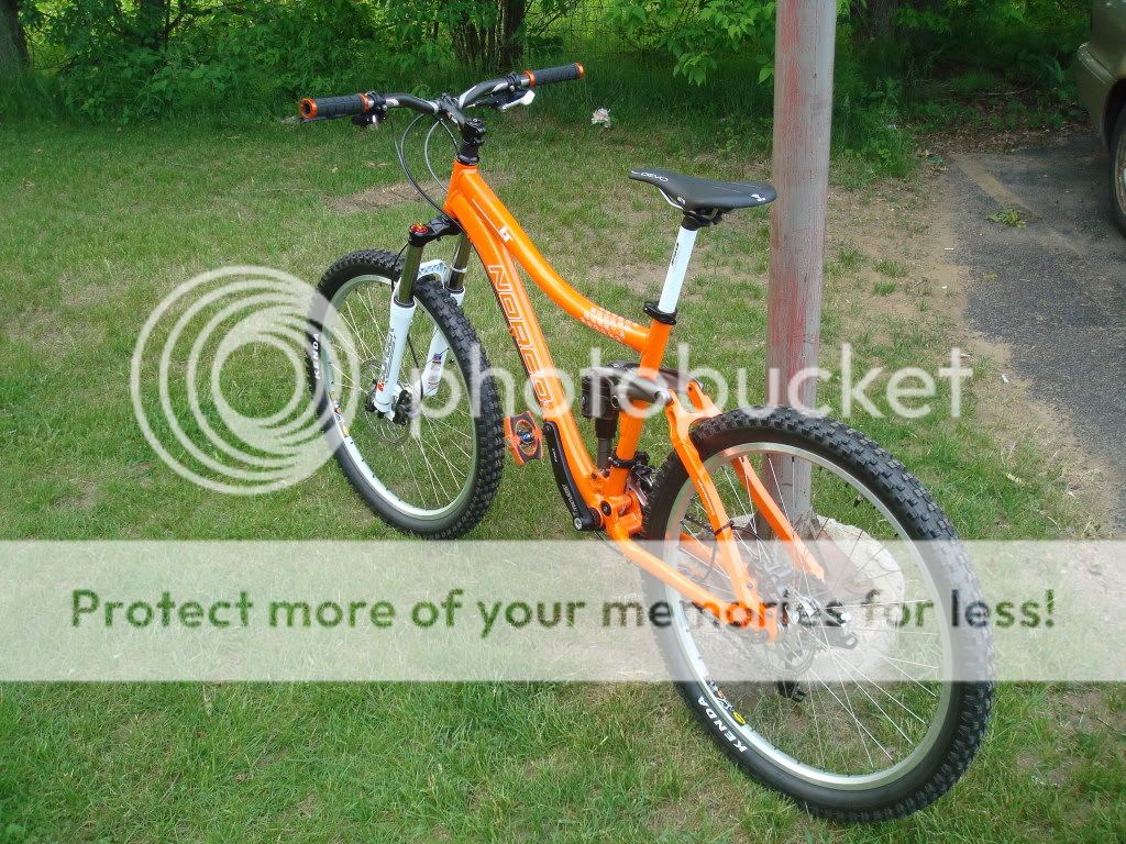

    So, I finally decided on something to build this year.
    Its based off of a 2009 Norco Fluid LT Frame that we had in the shop.
    Build spec as it sits so far:
    2009 Norco Fluid LT, size: medium, color: orange
    Fox DHX 3.0
    FSA headset
    FSA sl250 seatpost
    WTB devo saddle (for right now but will probably be changing)
    Marzocchi 44 TST Micro Ti
    Mavic 719's w/ DT 14/15 and brass locking nips on XT cl 36pt hubs
    Kenda Nevegal 2.35 dtc folding F - tubed
    Kenda Nevegal 2.35 stick-e wire R - tubed (I will be changing this out for a dtc folding to save almost a pound)
    American Classic skewers
    XTR cassette
    Truvativ Fire X crankset 22/34 and gxp BB w/ bash
    Shimano Deore Front derailleur
    Easton ea50 stem
    Answer Pro Taper Carbon riser bars
    Pro Palm lock on's - changing these as I don't like the orange lock rings.
    Shimano 8"F / 6"R cl rotors
    Parts I intend to add next week:
    XTR chain
    E-Thirteen DRS chain guide system
    Sram X9 shifters
    Sram X9 Rear Derailleur
    Shimano XT Front derailleur
    Hayes Stroker Trail discs F+R
    pedals of some sort
    The current build as pictured weighs 27lbs 2oz and is set up as a 5.5"f / 5.4"r trail config until I can swing a Marz 55 and a 20mm front wheel build. I should be able to build to 30lbs relatively easily in this set-up. The best thing about this is that I can switch the rear travel between 5.4" and 6.2" with one simple bolt. 2 builds w/ just a fork and wheel change, can't beat it.

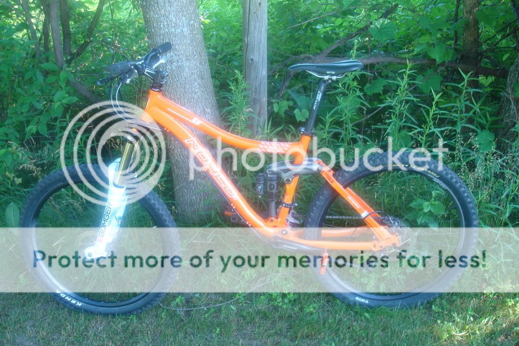

    Alright, so here it is as of last night. I've still got a few changes to make before its where I want it. Im awaiting the arrival of a Troy Lee Shiver saddle and some new ruffian grips and am considering a 60-70mm stem in white.
    Build Spec:
    09 LT3 frame
    DHX 3.0
    Marzocchi 44 tst micro ti 140mm
    FSA orbit sealed headset
    Easton EA50 80mm stem
    Answer pro taper carbon low rise H-bar
    Pro Palm lock ons
    SRAM X7 shifters
    Hayes Stroker Trails (rydes in pic)
    Truvativ gxp BB
    Truvativ FireX crank w/ 22/32/bash
    Crank Bros Acid 1 pedals
    XTR Chain
    XTR cassette
    Sram X9 rear derailleur
    Shimano deore front derailleur
    Mavic 719 rims
    DT Swiss 14/15 db spokes w/ brass locking nips
    XT 775 hubs w/ american classic skewers
    Kenda Nevegal 2.35 dtc folding tires - tubed
    FSA sl250 seatpost
    WTB devo seat

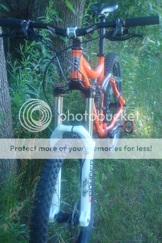

    Here it is now:
    New build spec:
    2009 Norco LT
    Fox DHX air 3.0
    Marzocchi 55 Micro Ti Fork
    Roval AL wheelset
    Kenda Nevegal 2.35 dtc Front
    WTB Prowler 2.3 rear
    XTR Chain
    XTR Cassette
    XT Crankset
    RaceFace X-Type Team DH BB
    SRAM X9 rear derailleur
    Hayes Stroker Rydes F+R w/ 6" clean sweep rotors
    FSA headset
    Specialized 70mm stem w/ micro adjust
    RaceFace Evolve XC riser bar
    Specialized Enduro XL grips
    SRAM X7 shifters
    Ritchey Pro seatpost
    WTB Devo saddle
    Crank Bros Acid pedals
    Monday I am planning on switching to tubeless Purgatory 2.4 front and Captain 2.2 rear and will be switching out the grips for some ODI's. Also have a brand new pair of 8" clean sweep rotors to put on.<!-- / message --><!-- sig -->
