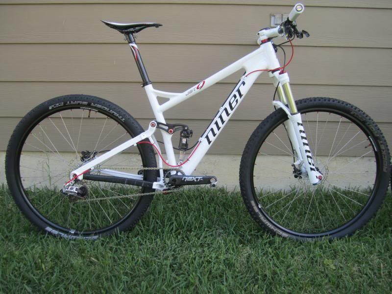

    I bought one of the $1899 Jet 9's from PricePoint with SRAM X7, Hayes Stroker Ryde brakes and a bunch of Sette stuff. It weighed 31lbs. and 3oz. when I got it but that wouldn't do so it went on a diet.
    Well after changing Everything except the frame, fork and headset I got it down to 22lbs. 5oz.
    Well I wanted a black wheelset so I built another set with the same hubs (Circus Monkey) same spokes and nipples (Ti and Alloy) but with American Classic 101 rims and got it down to 22lbs. 3oz. The white rims are heavier because of the powder coating. Well that was almost enough but I put my Crank Bros 4ti pedals on, took off the Bell and bottle cage and got it to 21lbs. 11oz.
    Here are some close up shots of some of the componentry.
    Frame Niner Jet 9 Medium
    Fork Manitou Tower Pro 120mm
    CaneCreek 10 headset........................................... ........ 4988.5g
    RaceFace Next SL carbon cranks with 26t N/W ring..............504g
    Crank Bros 4 Ti pedals............................................ ........174g
    KMC X10SL DLC chain............................................. ........221g
    eBay carbon bar............................................... .............138g
    eBay carbon post.............................................. ............144g
    eBay carbon saddle............................................ ............100g
    eBay 80mm stem with Ti bolts..........................................86g
    Formula R1 Racing brakes with alloy fixing bolts...................342g F/R
    Ashima Ai2 rotors with Alloy Ashima bolts...........................154g F/R
    Esi chunky grips cut to my hand width...............................46g
    Esi bar end plugs............................................. ...............6g
    Fouriers headset cap with alloy bolt...................................6g
    American Classic 101 rims.............................................. ..762g pr.
    Circus Monkey hubs.............................................. ..........355g pr.
    Titanium spokes and alloy nipples......................................249g
    Stans yellow tape and alloy valves....................................14g
    Rocket Ron 2.1" tires........................................450g R and 471g F
    Stans sealant, one syringe per tire....................................120g
    SRAM XO rear shifter........................................... ...........105g
    SRAM XO rear derailleur with AESM jockey wheel.................176g
    SRAM XO 10spd 11-26 cassette.......................................230 g
    Parts of Passion headset spacer 10mm...............................4g
    Halo Red bolt on skewers with Ti rods................................44g
    Every single bolt on the bike was replaced with Titanium or Aluminum.
    I don't know what the shifter cable and housing weigh but they don't matter in weight. I could get the really expensive cassette and lose another 70g. or 2 1/2 ounces. Maybe later. After being on a rigid SS for years I am Loving the squishy bike. Heck if I had the Jet 9 RDO frame I could lose another 1.74lbs. Maybe soon.

    The way I ride it everyday with the bottle cage and bell it weighs 22lbs. 3oz.

    How is the Manitou Tower fork working out for you? If you have used Fox forks before, how would you compare the Manitou? I am thinking about purchasing a Manitou myself.
    bike rider
    Reputation: mattkock's Avatar
    1,143
    So far I really like it. I've ever only had RockShox forks for XC and I have a FOX 40 on my DH bike but the suppleness of the Tower Pro is really nice. It's pretty stiff with only a QR front axle so with a 15mm Thru it should be great. Before I cut the steerer tube my 120mm Tower Pro weighed 3.74lbs or 1696.09g, if you're into that kind of thing. I like it so much I already got one for my SS Niner too.

    There isn't any "ish", about that bike. Well done. My Gen 1 RDO setup 2x10 weighs more than your bike.

    I have never built a bike to hit a weight. I just build bikes that I want to ride with parts that I have already tried and liked or wanted to try. I have ridden every part on this bike on other bikes that I own and really liked them but the new stuff that I wanted to test out are the American Classic 101 rims because they are as light as Stans Crests but as stiff as Archs and the Raceface Next cranks because I was kind of tired of riding cranks from the 1990's. So far I like my choices with the new stuff. That being said now I'm a little curious to see what this thing would weigh built up on a Jet RDO frame. I think it's 1.74lbs lighter than the alloy one.

    Well you had me fooled as all your bikes seem to end up very near to a rounded pound
    Seriously nice bikes and component choices, I am running Manitou Tower Pro's on my Banshee Paradox.
    My Jet 9C frame just arrived and it is 2317grams for the large. RDO is probably a few grams lighter.

    How did you like the crest rim and circus monkey hub combo? I'm thinking of building a set.
    bike rider
    1,143
    I like them a lot but the Crests were flexy compared to the American Classic 101 rims. I like the AC's so much that I have the exact same wheels on my Jet and SIR. The 101's weigh 1g more than Crests but are as stiff or stiffer than Arch's.

    Thanks for the reply. I think I'll skip over on the crests then. are the hubs decent? Ive heard the older ones had a tendency to self destruct
    bike rider
    1,143
    Yeah I blew up a set of the old ones but I've had zero issues with the HDW2 and the HDW3's are really nice. My 101's on HDW2's and Ti spokes with alloy nipples weigh 1401g with Stans yellow tape and valves. Crazy light for not much money.

    How is the ride of the RS monarch on the jet? Looking at two closeouts - one with an rp23 and one with a monarch. Any regrets?
    bike rider
    1,143
    I really like it. It feels like it has way more than 80mm of travel. I bought the PricePoint one and changed everything but the frame and headset. I rode one with the Fox and it isn't as nice, a little harsh and yes I set them both up to my weight.

    Here is the new rear tire I'm putting on my JET. It's a 2.1" Schwalbe Thunder Burt. I'm also going to build up a set of 35mm wide eBay carbon rims on Chris King hubs with Ti spokes and 2.35" Knobby Nic tires for some of the Gnarlier trails in Austin and out further west.

    I bought the 100mm tower fork for my A9C build. Reviews were great and price was way cheaper with the PP sale. The fork looks way better with the niner sticker than the manitou ones. Not important but i noticed it right away.

    Ok so I've got some mileage on her and she is sweet. I've changed the shift cable to a Gore Ride On, the rear tire to a Thunder Burt, the saddle and I daily on Egg Beater 1's. 21lbs 14oz is her daily weight and I really enjoy being on a squishy bike after 17 years on a rigid SS. It feels like my DH bike. Here she is how she sits now.
    Here she is with her twin SS. Every single part is the same except the seatpost and of course the stuff to make the Jet squishy and geared.

    I know this post is a couple months old but can you tell me what water bottle cage this is in the photo?

    It's a Blackburn cage. I really like them.

    Good tip on the Tower pro forks! I got an 80mm for my hardtail and they're nice and plush. They certainly punch above their weight for the price!

    How has your experience been with the Ti spokes? Can you feel flex or springiness in the wheelset compared to stainless spokes? Any issues with corrosion and the allow nips? I'm about to build a 26" wheelset for my daughters bike with Ti spokes, alloy nips, but she is so light a brisk wind almost knocks her down.... I'd like to build a set for myself, but I'm 195 naked, so unsure if that would be wise.
