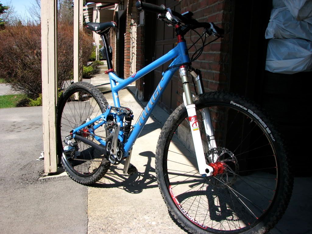

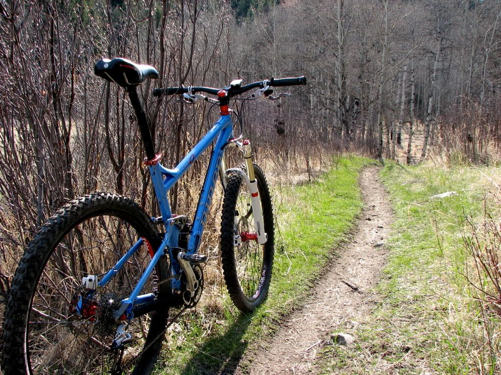

  • 05-15-2008
    hizzity
    -Trail location/terrain: Canadian Rockies/kananaskis country
    -Frame Year/Size/Color: 08/large/blue
    -Rider Weight: 235
    -Rider Height/Inseam: 6'4"/35"
    -Stem (length/rise): thomson 90mm
    -Seatpost: thomson 410mm
    -Handlebar: syncros bulk race 20mm rise
    -grips: egron enduro
    -headset: hope
    -Rear Shock: fox rp23
    -Rear settings 170psi
    -Fork: manitou 120
    -Fork settings 150psi, 1 click of platform
    -Brake Setup: hayes stroker trail 8" front, 7"rear
    -Drivetrain Setup: xt cranks, xt fd, sram x9 rd and shifters, sram 34-11 980
    -Tires: panaracer rampage
    -Wheels: stans flows, hope hubs 36 hole, haven't gone tubeless yet.
    -pedals: time roc atac
    -Build Weight: 30-32lbs on bathroom scale
    only have 3 rides on it so for and it rocks. it pedals so well, but is also very playful, can't wait to get allot more miles on her.

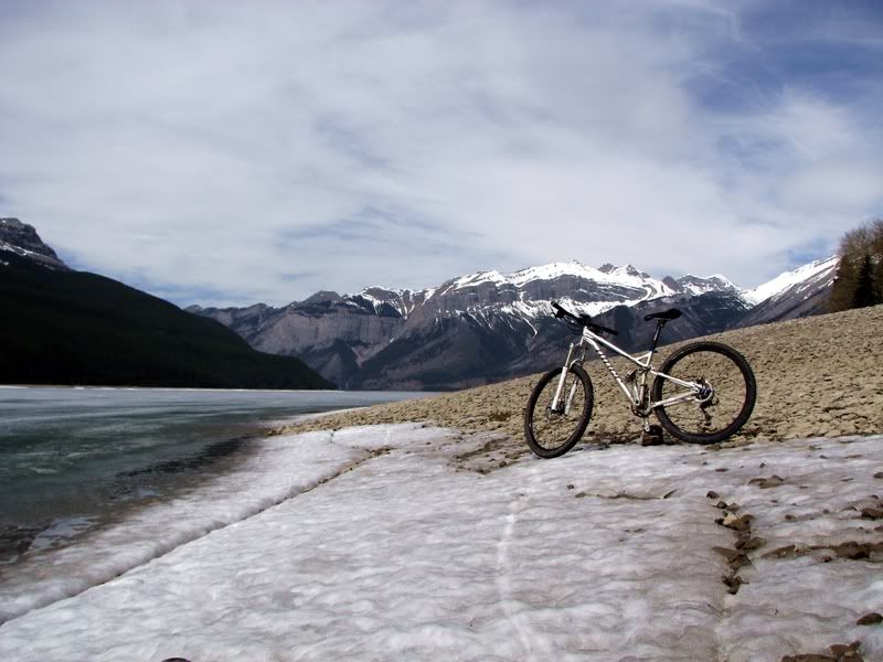

  • 05-17-2008
    ferday
    ok i'll play`
    -Trail location/terrain: Canadian Rockies, far backcountry
    -Frame Year/Size: 07 small
    -Rider Weight: 155
    -Rider Height/Inseam: 5'6"
    -Handlebar: groovy cycles
    -grips: lockon
    -headset: king
    -Rear settings 115psi
    -Fork: manitou 120
    -Fork settings 110psi
    -Brake Setup: stroker trails
    -Drivetrain Setup: xt cranks, xt fd, xtr rd and shifters
    -Tires: rampage/fireXC
    -Wheels: stans flows, king hubs 36 hole
    -Build Weight: 30lbs
    fast, smooth and stable.
