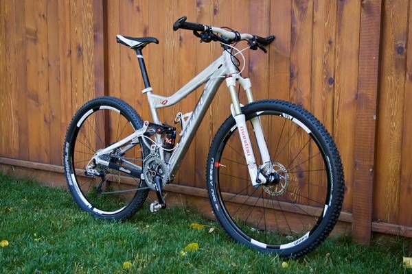

    Snagged an alloy RIP frame off PP and built it up with some parts off my SIR. Have ridden SS for the last 8 or so years and went with 1x10 XTR for the drive train. Got a Pike RCT3 140, but it showed up with the lower right fork leg covered in oil and began leaking oil out of the rebound knob a few days later after sitting with no ride time to speak of. Sent it back, waiting on the replacement, gonna get some better pics then. Might consider an angleset after I get some solid ride time on it to slacken it out a bit. We'll see though. Parts list below:
    RIP9 alloy frame, monarch rt hv
    16 RS Pike RCT3 140mm
    Hope Race X2 Brakes
    XTR RD+RS 1x10, 11-36 (personally don't need that ultra low gearing)
    Velocity Blunt SS Rims, Chris King ISO Hubs
    Next SL Cranks
    Weighs 26 lbs exactly, not too shabby
    Niner RIP 9 Alloy

  38. #1188
    Feb 2015
    21
    Getting there.
    I robbed my girlfriends wheels just to get it off the stand. Flow MK3's will be here tomorrow.

    Feb 2015
    21
    Now just needs tuned.
    Couldn't ask for a better ride. Full XTR.
    Attached Thumbnails Attached Thumbnails The RIP9 Setup Thread (all years, forever and ever)-image.jpg
