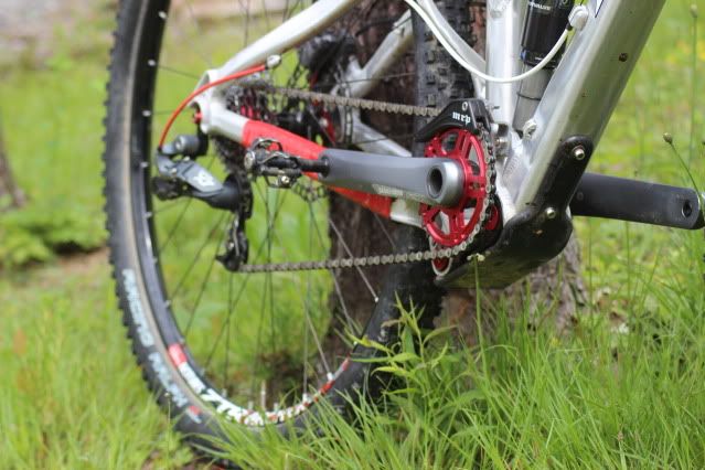

    1x9. 30t ring. 11-34 cassette. x7 short cage. MRP guide. skid plate. zero issues
