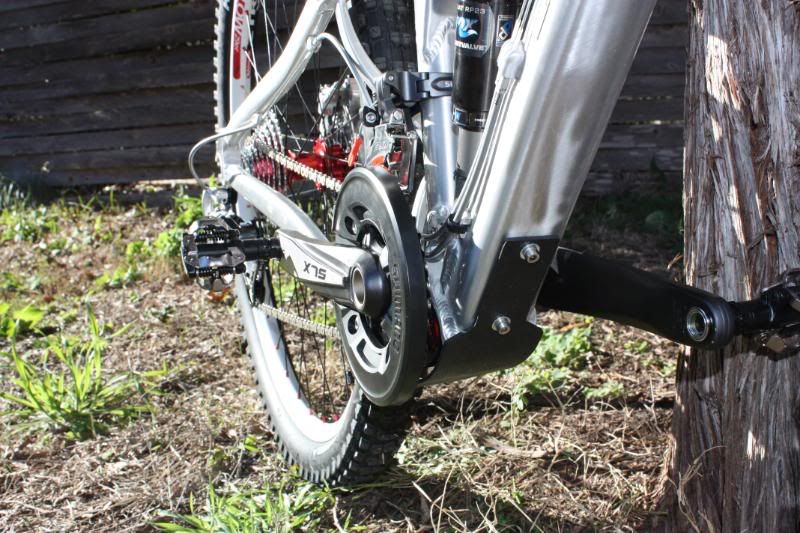

    2dmax - did you fab that linkage bash guard on your niner? Pretty cool
    Reputation: 2DMaxLST's Avatar
    151
    I purchased the guard on here.... let me check for a link..
    2013 Niner RIP 9
    2012 Niner RIP 9
    2010 Niner JET 9
    Reputation: schnee's Avatar
    1,797
    Dude who makes the skid plate is cytoe@msn.com
    I bought one too. It's awesome.

    Quote Originally Posted by schnee
    My skid plate bangs on my chain and makes a nasty racket. I took it off but you may have better luck....
