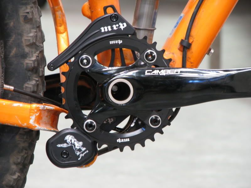

    We just tested the fit of our new Lopes guide on the Rip and it's a winner. The BB squeeze mount version is shipping now. Check it out....

    Here it is on the bike. MRP Lopes SL guide w/ Camber Crank
    JMH, I'm not aware of any products in our current lineup that will work with 2 ring on that bike. But we're always coming with new stuff!

    Sweet! That Lopes guide looks perfect. The Straitline guide also looks like it would work if they made it in a bottom bracket mounted version.
    I ended up buying a Gamut P20 and after a little modifying it works great. I just had to take the lower pulley nut off the back and cut the excess bolt off flush with the back. Then, in order to get the bolt to stay in the boomerang I semi crushed half the threads and used heavy duty lock tite. I took it on a couple long rough descents yesterday and it worked great. It's amazing how much less noise the bike makes while descending when you have a good guide. Very confidence inspiring.
    I will be getting the Lopes guide this winter when I get the extra cash.
