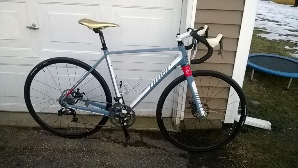

This build looks like SRAM Red. I can't zoom in enough on the picture though to confirm for sure. That would open up alot of option for cranks.
