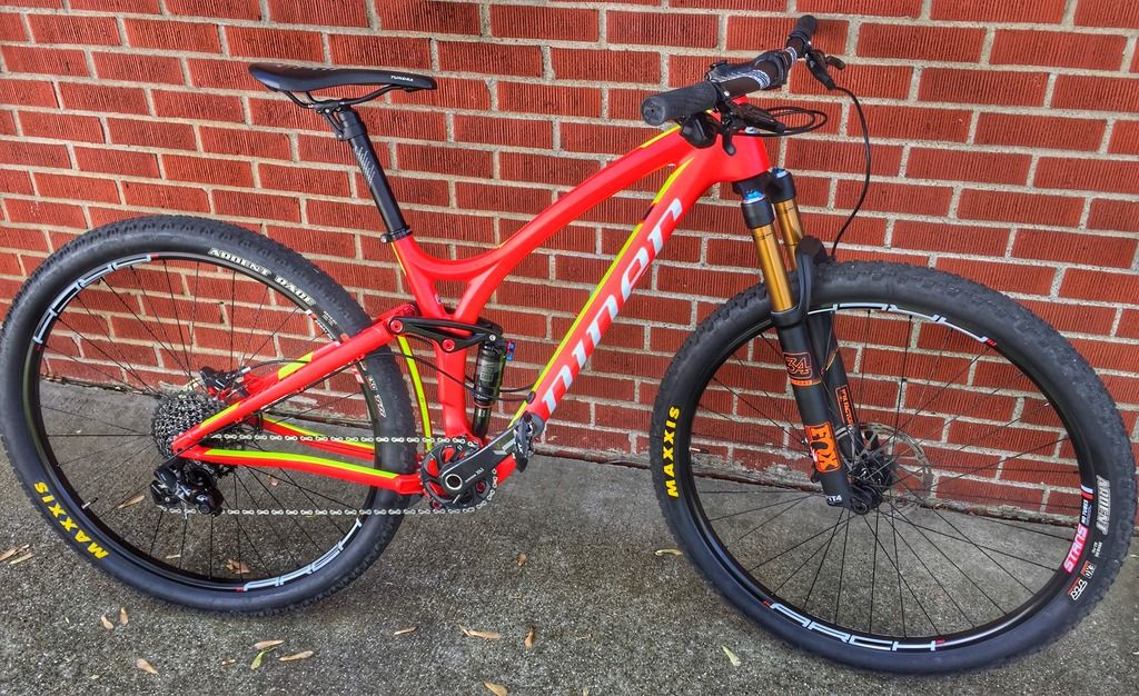

    Reputation: coke's Avatar
    1,292
    29x2.6 Nobby Nic, 30mm internal rims, Small 2015 Jet Carbon. No clearance issues.

    looks great. Spent anytime on the trails yet with them?
    1,292
    Quote Originally Posted by AZmtncycler View Post
    The Jet 9 above is my wife's bike. She really liked the traction, but since this is her race bike she asked me to put on some lighter and faster tires.
