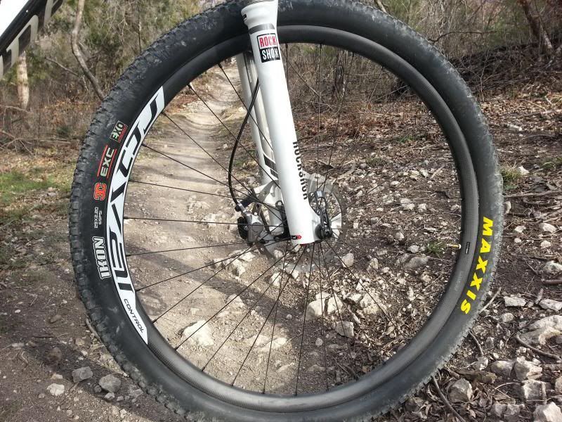

    I just put carbon hoops on mine, they are awesome.
    Quote Originally Posted by ozynigma View Post
    Thanks Bruce, you have given me a lot to think about. I got the Crest rims for half price (and more importantly they are white). I have just been checking out the Light Bicycles ebay page for Australia. I could probably get my money back on the rims and even the hubs if I buy prebuilt wheels from China.
