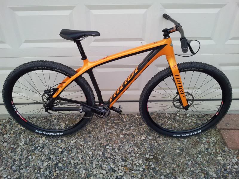

    My first Niner build.
    Finally invested in a new bike. Picked up an Air 9 carbon frame on a good deal and built it up. Lots of first's on this build. Never built a bike, never rode a rigid or SS. Went from an entry level Gary Fisher to this.
    Not 100% finished at the moment. Still need a half link in the chain. Having troubles getting it perfect. Front brakes on and rear line shortened. Also waiting for my new seat to ship to me.

    I don't have much experience with hydro brakes. My last bike had a set of mechanical disc brakes on it. I got a sweet deal on a set of Avid Elixir 7's so i put them on. The rear seams a little squishy to me but im going to have my LBS bleed them for me.

    Yeah i did get it with the EBB. Nice invention, only wish it had full rotation. Seems like the spot that would getmy chain perfect is either where the bolt hits the cable guide in the shell, or the BB hits the cable guide. Not sure if the EBBII has the same issue.

    i think you can take that cable guide out. mine is not in there, but i ordered frame as singlespeed with ebb2 and dropout adapter. someone on here will know better than me, i just built mine a month ago/1st niner

    Yeah the light bulb finally turned on earlier today and i ended up taking the cable guide out. Took it out and got the chain tension perfect. Took the bike out this evening and it rode amazing.

    Here's the goods list:
    Niner RDO stem
    Niner carbon bars
    Avid Elixir 7 brakes
    Thompson elite post
    WTB silverado team saddle (Back ordered)
    Stans ZTR arch wheels
    Sram x9 hubs
    DT Swiss spokes
    Schwalbe knobby nics 2.35 F and R
    Sram XX1 crank
    Niner cogalicious cog
    Surly spacer kit
    Sram PC1051 10 speed chain
    Eggbeater pedals
