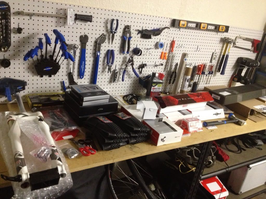

First ride complete, I absolutely love this bike. This is also my first ground up build and I happen to be rather proud of it. It also gave me an excuse to buy some great tools (star nut setter, crown race setter, headset press...)
On the first go, my bb to chainstay housing was too short. I was banging my head against the wall, then I came here and read about 120mm housing. Re-cable the aft section, shifts perfectly.
Lastly, XX1 is just the trickest kit out there. Always having any gear on demand is going to make me lazy (or give me freedom to concentrate on other things.) If you have the means, I highly suggest picking it up.
Enough commentary. Build specs:
White Jet 9 RDO v1.1
SID XX fork
Cane Creek/Niner headset (had a red chris king ready, wont fit, oh well.)
Enve bars
Niner Rdo seatpost and 90mm stem
XTR brakes and 160 rotors
XX1 crank, rear d, chain, cassette
Stan's Crest rims built on DT 240s
Kenda Small block 8 tires running tubeless
Specialized Toupe saddle
Need to trim brake cables, and slam the stem. Still getting all adjusted.
