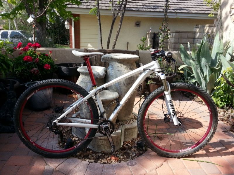

    The guys riding mediums. How high are your bars? Are they above the saddle?
    Sep 2012
    281
    ^ Mine looks about like that as well.

    Reputation: RS VR6's Avatar
    4,268
    Thanks for the pic!

    Here is my GF's small EMD. She is 5'6" and her inseam is also roughly 30in. The stem is 80mm and -6. With 15mm of spacers under the stem.
