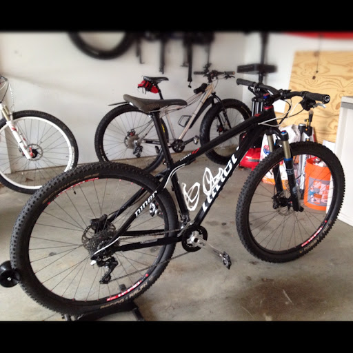

    No rides yet - the week has been unkind to me. But here it is. Still waiting for the red headset spacers to come in, but essentially finished. 26.8 # as she stands now.

    A beauty!
