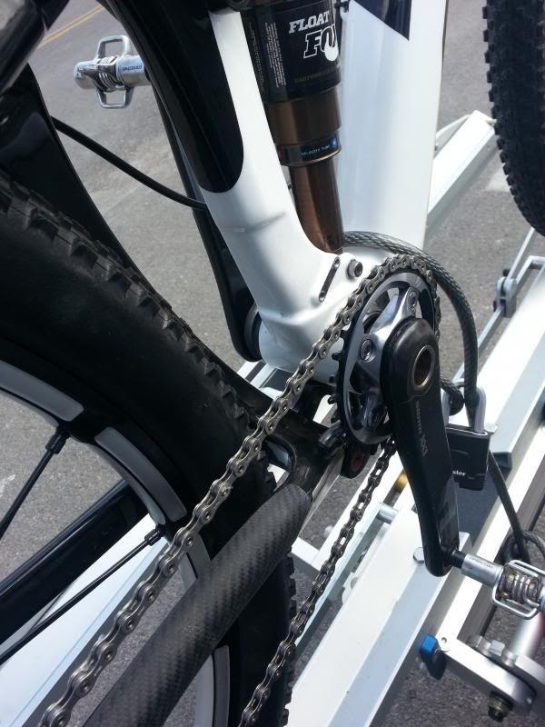

    Awesome build! Can you post some closer pics of your the derailleur cable routing?

    No just run the cable the way it is ment to be, it is nice & eazy on the Air9 RDO.

    I carefully applied some very sticky tape to the inside of the head tube to seal up the holes and then filled the badge wholes with some silicon shower caulking I had lying around. On the exit side near the BB, I unscrewed the plastic cable guide and covered up the hole with clear frame protection tape. Perhaps I wouldn't have had a problem doing it the "proper" way, but I presonally prefer external full-length cables runs. Full length cables will only potentially shift better, have less contamination problems, are easier to replace (no fork drop!), and I think it even looks more balanced.
    Here's a better picture of how I routed the cable. I have securely routed the cable along the right chain stay after it crosses from the left side of the frame in front of the rear shock and behind the chain ring. I put a little bit of electrical tape on the cable where chain might slap it, but since it's XX1, there is very little chain slap. I'll take some better pictures of the routing later, but the bike is currently in the shop getting the brake lines shortened.

    For anybody interested in how I did the external XX1 cable routing, here are a few pictures. Super simple and very solid.
    First Niner! Jet 9 RDO, XX1, I9 Torch 24 wheels, etc-jet9rdo_cable_routing-1.jpgFirst Niner! Jet 9 RDO, XX1, I9 Torch 24 wheels, etc-jet9rdo_cable_routing-2.jpgFirst Niner! Jet 9 RDO, XX1, I9 Torch 24 wheels, etc-jet9rdo_cable_routing-3.jpgFirst Niner! Jet 9 RDO, XX1, I9 Torch 24 wheels, etc-jet9rdo_cable_routing-4.jpg
