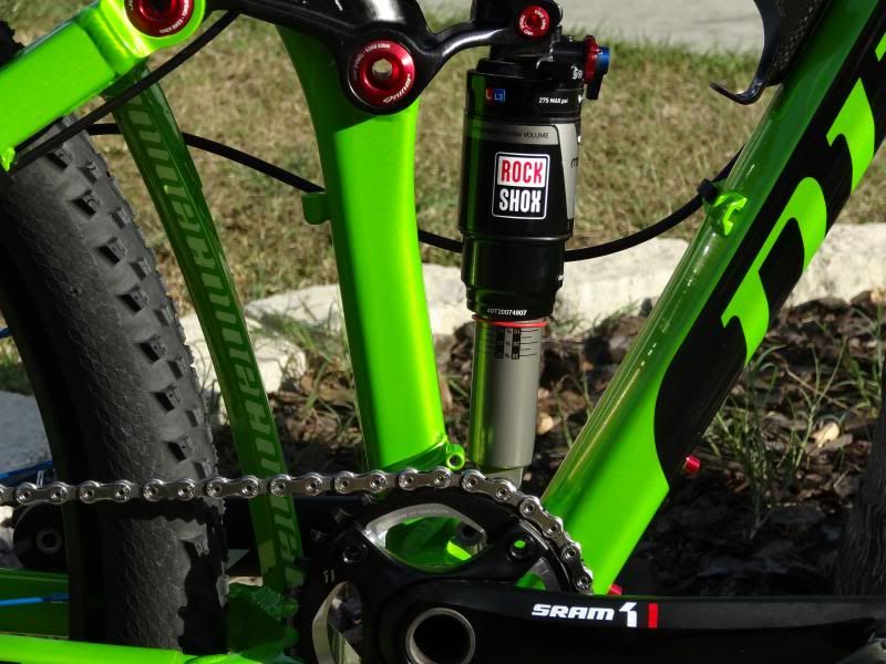

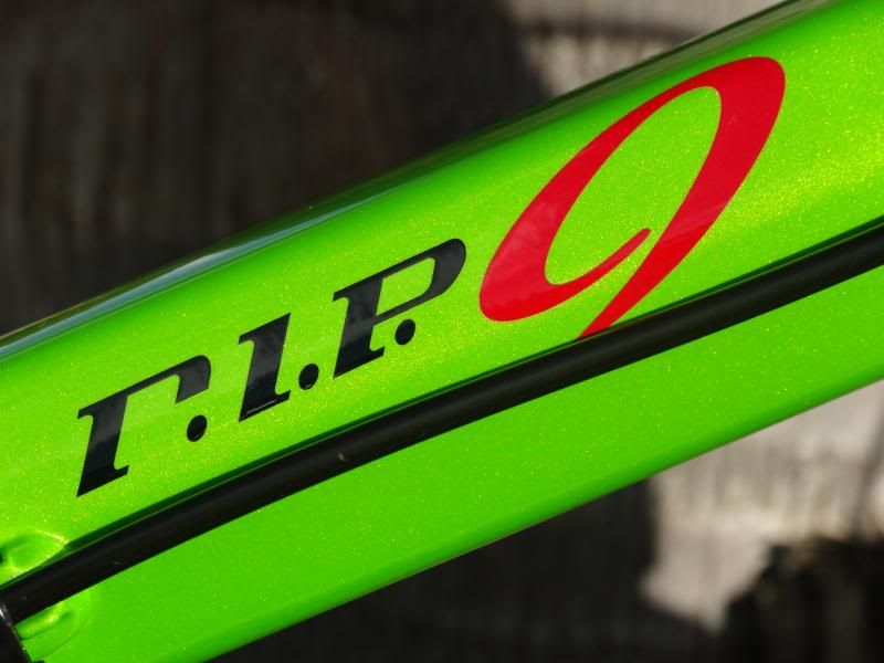

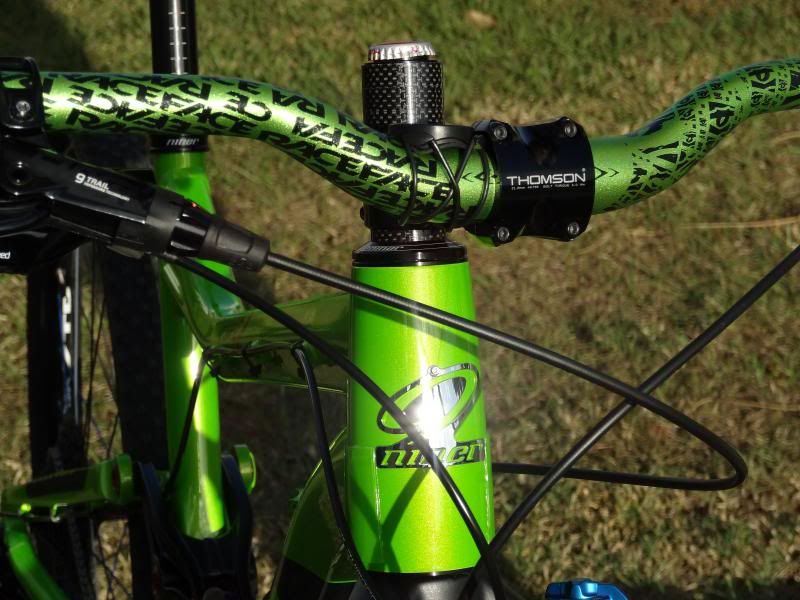

    Pics first!
    [URL=http://s109.photobucket.com/user/Coach417/media/DSC00991.jpg.html]
    2014 Alloy RIP9 Large
    Fox Talas 34 140-110
    Sram XO1 1x11
    Avid Elixir 9 Trail brakes (the new 4 piston set)
    Profile Elite hubs/Arch EX rims
    Conti X-King Protection 2.2/2.4
    I have a about 100 miles on now. So I figured it would be time for some thoughts. My previous Niners were the gen2 Rip in '09 and an 80mm travel alloy Jet. Loved the RIP, liked the Jet. I have ridden 29ers exclusively since '06, although I demoed the new Giant Trances (Advanced, SX, and Trance 1). 27.5 is not for me. I am coming off a 15 month relationship with a pimped out Trance X O. The Trance is a great bike, but for me was more of a long travel XC bike. I know there are guys that could go ride the Red Bull Rampage on it, but I am not that guy. The new RIP is very stiff, pedals great, and handles nicely. I even got to ride my old bike today, no regrets.
    Things that stand out for me. The 34 Talas, WOW, I think the new Fox forks are a HUGE improvement over the last offerings. Nicely progressive, no deep dive, good small bump compliance. But, the most important is how much stiffer the 34 is. Absolutely confidence inspiring. The frame's stiffness is just what I was hoping for. The Trance was very light. 6 lbs or less for a large. the RIP is more like 7 I would guess. I had my Trance down to 27 lbs. 4 oz. with NO carbon. The Talas is about .75 lb heavier than the old 32 Float, and the frame is 1 lb. heavier. The RIP is currently tipping the scales at 29 lbs 4 oz. For ME, the extra weight is well worth the trade off.
    Negatives. I have yet to get full travel out of the rear or fork. The exposed stanchion only measures 135mm on the fork and I am moving the O ring up to about 10mm from the crown. The rear, I am guessing that I am using about 115mm of the 125. I am 6' 195ish ready to ride and running only 110 psi in the fork and 170 psi in the Monarch. I always got full travel out of the Trance. Next ride I will drop 5 psi front and rear. The ride is plush enough and pedals great. As a matter of fact, it is the best climber I have ever owned! (and that is leaving the fork at full travel).
    Eventually I will build Light Bike set of wheels with my Profile hubs. Also, will put my XT brakes on instead of the Avids.

    Nice bike! I like the color matched bars.

    Not to nitpick, but one thing I noticed is you have the rear derailleur cable running along the cable guides for a dropper seatpost. It should run along the right side of the downtube, mirroring the rear brake cable on the other side.

    Feel free. I didn't build it, but agree, it looks a bit odd. There is actually another guide right below that one. As in there are two sets of guides on the rt. side of the top tube. As a side note, I realized i am getting full travel out of the rear. The shocks stroke apparently does not travel the entire length. Not sure if I am saying that right, but I took all the air out of the shock and compressed the bike and there was still 10mm of shock exposed.

    The other set of guides would be for front derailleur.

    Der. Cable rerouted. Much cleaner. I remember my other rip and jet going that way.
