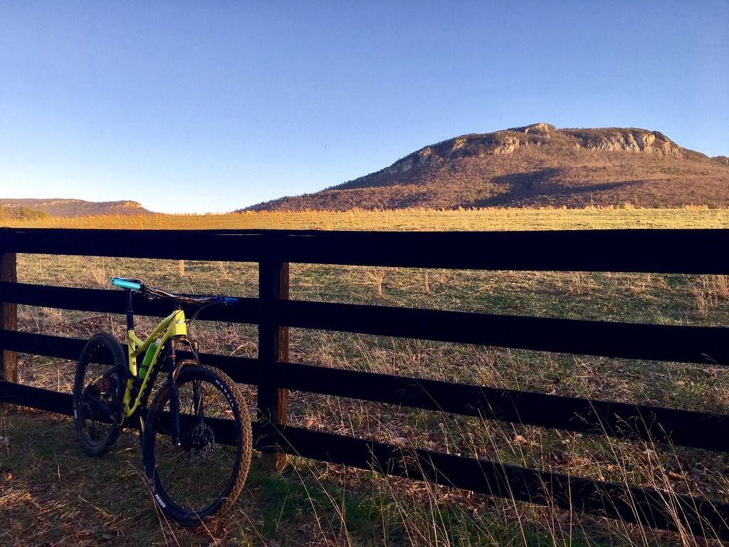

    2017 Jet9 RDO build
    I picked up a Jet 2 star build from Jenson from their winter blowout. Pretty good deal when adding in the activejunky refund. The only stuff I've changed is the bar/stem to Easton Haven and set the wheels up tubeless. It was 29.8 lbs stock, but down to 28.2 after the few improvements. Should be loads of fun in Pisgah without being a lumbering oaf up the gravel road climbs. I'd eventually like to put on a set of Industry Nine Enduro 305's, but the bike alone was a painful stretch on a NC teacher's salary. Someday...

    Nice bike Froth! Let us all know how she rides after you get some miles on her.

    OP love that color. I really am enjoying my RIP9 that I picked up last august, am sure you will enjoy the JET down there in WNC. I hope to visit your area this year sometime too.

    I had the chance to get a little shakedown ride the other night,but will get a legit big mountain ride in Pisgah tomorrow and Saturday.
