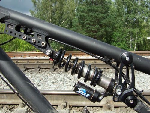

    Okay, so i weigh about 87kg and the frame came with a 450lb spring which should be fine. I was considering changing the fox steel one for a ti one and was indeed wondering if i just need to get another 450lb ti spring of the same length?
    As for the moving the mounts, the front is mounted one hole back from the shock end, so 3 on one side and three the other, this move will lower the BB height (yes?)
    At the rear mount it is currently in the seconf hole down so if i want max travel i simply need to move it to the top hole (right?)
    If i want max. BB height i need to move front mount forward to hole nearest front end of shock (right?)
    Thanks for all your adivice...keep it coming...
    Can i use a standard CK headset? I have no intention of jumping just pounding through so some rock garden type stuff, opinion seems divided and i have seen many recommend a deep insertion headset....opinions?
    Thanks again
    Mark
    lazy piston
    Mar 2006
    373
    Quote Originally Posted by shiny1973
    Well I'm ~82 kg ready to ride and I have a 450lb spring at the moment (I own an '07 FR just like you) and I find it a bit on the soft side and the suspension tends to bottom out a bit more often than I'd prefer (I have a 500lb spring around but just haven't decided whether I want to swap the springs or not). So if I were you I would be looking at a 500lb one at least, maybe even 550lb.
    If I get what you're saying, yes, your BB is now lower than it could possibly be.
    Yes.
    You'll have to move the front mounting plates backwards so that they're positioned like this:
    Theoretically you can move them even farther backwards, but this way there'll be only 4 bolts holding them in place instead of 6, and it may affect the geometry in a bad way.
    You may but it will void your warranty on head tube ovalization. I've seen numerous Nicolai builds with standard headsets and people don't seem to be bothered a lot.
