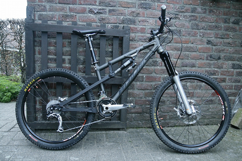

    From Belgium, to form a nice partnership with my Helius CC I could not resist bying this wonderfull AM frame as a demobike from Nicolai.
    * Frame, Size, & Color: Helius AM Small, titanium anodized front/ black rear triangle, tapered headset, 12 mm axle
    * Fork: Marzocchi Z150 FR SL
    * Shock, i2i, stroke: Fox DHX air
    * Brakes: Hope M'
    * Cranks: XT
    * Shifters: LX
    * Front Derailleur: SLX
    * Rear Derailleur: XT
    * Pedals: Shimano
    * Stem: Syncros
    * Handlebar: Syncros
    * Seatpost: Roox
    * Saddle: Syncros
    * Bottom Bracket: XT
    * Cassette: XT
    * Chain: XTR
    * Headset: Reset tapered
    * Grips: Syncros
    * Front Tire: Maxxis Minion
    * Front Rim/ Spokes: Flow rims wit sapim spokes
    * Front Hub/Skewer: Hope Pro 2 EVO
    * Rear Tire:Maxxis Minnion
    * Rear Rim: Flow rims with Sapim spokes
    * Rear Hub/Skewer: Hope Pro 2 EVO
    * Cables: Jagwire
    * Misc:
    * Overall Weight: < 15 kg (I hope)
    Besides that, a small question.
    I have a blackspire chainguide for ISCG mounting, when installing it, the bolts that secure the guide touch the bolts that hold the smallest chainring on the cranks. I mounted the crank bearrings with 1 spacer on the drive side as suggested in the manaul. Any tips to make this work?

    Your setup is just fine with the spacer right where it is. But Nicolai faces the ISCG tabs plane with the bb. They do this so that one can bold Hammerschmidt right away. Downside is that there is no offset, which means less space for the guide and its bolts. Grinding down the bolts on the Cranks usually helps, or finding some with a smaller head. I run my setup with a Gamut Dual guide and it fits just but well.

    K2-Man - I think I recognise that AM. Was it bought from the Nicolai Stock List? Absolutely stunning finish on it, with that combination of titanium and black anodizing.
    Have fun on it and when funds allow, treat it to a lighter set of forks

    Yeah ha K2-Man..... A true stealth machine.... Enjoy and whack a new fork on that puppy....

    Yes it is, straight from the factory. It was a real bargain ! I am looking for a Lyrik Air to make the build complete ...

    In progress ! Indeed front and back are not in balance right now.

    Hello, I ordered new shockplates to lower BB and slacken the Head Angle. I had sent an email to Nicolai to explain my problem and they had sent me two sets of shockplates to tweak the bikes geometry. I am running now with -15 shockplates wich results in a headangle between 65 and 66 degrees (measured with a smartphone app so pretty unreliable)

    Hello, The guys at Nicolai told me the tire will hit the seattube if you use the -15 mm plates in the 170 mm setting. I checked this my frame without damper installed and there is enough room, small frame.

    Hi K2 man,
    thanks for that info and pic, it's very interesting to know that Nicolai have a "range" of plates. Please might you answer a few more questions?
    What frame was that by the way and what year, what shock? -13 is a BIG BB drop I'd have thought, unless you also had a longer than standard shock?
    What is your bottom bracket "rise" now? (in case you don't know that's the BB (centre axis) height above the wheel axle centres. BB height measurements are somewhat meaningless as that dimension changes with tyre size.
    Did the minus plates alter the suspension feeling? It puts the linkage into a different part of it's "rate" so perhaps that might happen?
    You're right to doubt the smartphone app, for quite a while I was convinced that my AM frame angles were too steep, but it was all down to app/iPhone inaccuracy. The issue of inaccuracy was revealed when I measured the seat tube, it seemed to be tapered!
    I checked by measuring the front and back of a fork stanchion which is obviously not tapered, this inevitably involved inverting the iPhone to avoid the buttons on one side of it - the measured angle changed by about 1.5 degrees.
    In retrospect, knowing that the iPhone was not designed to measure angles and has no sensor for that, the even level of accuracy it does have is amazing, so, OK for comparisons but not for outright reference measurements.

    Replied witthin the quote.
    Quote Originally Posted by mudfish801 View Post
    Hi K2 man,
    Running a AM frame in size small with a Rockshox Monarch plus Shock. I think it is actually 2010 or 2011 (not 100 % sure). Maybe you can tell from this link: none at none in Zonnebeke, Belgium - photo by K2-man - Pinkbike
    Not sure, never felt the need to measure it.
    Only thing I can say the suspension feels little more progressive.
    Hey, anyone out there got any shock mount plates around -5 to sell or loan for test please? I think that would give me a BB rise of about 10mm - same as the new ION 18 and 20 - great for Alpine descents, not so great for pedal strike perhaps, lucky those plates allow swopping between settings when the bike is set for different terrain.
    If you come to belgium you can experiment a little bit. I have three sets now

    thanks very much K2man
    what a really great looking frame colour, Ti, I guess with black painted back end? '
    - it's hard to tell which AM you have, the shock length would partly give it away though, I believe the '10 had a 200mm shock and the '11 a 216mm.
    Looking at your shock mount plates in the pic they seem to be "-?" ones - yours might be a "transition" model, you could say an early '11. - in that case I believe the top tube had the same welded on mounts as a '10 frame and using the new '11 links and adjusted shock mount plates made it able to take the 216 shock.
