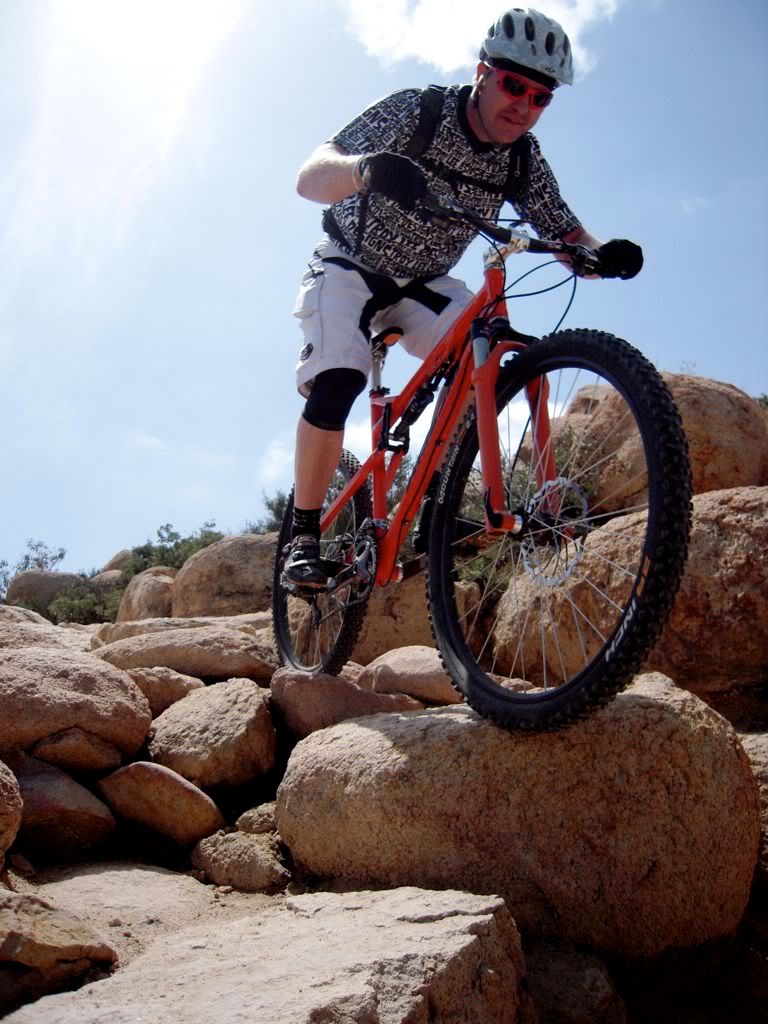

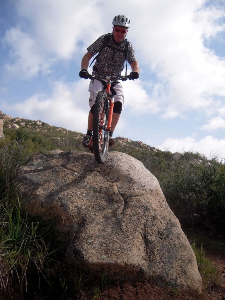

    Great thread. Sorry have not responded sooner. That work thing has been full on of late...
    Check out the below threads on my AC29er.... Of which is 28.9 lbs.... It is built not to be light as it could be. 20mm front axel, 12 mm rear axel, ti HS, Ti bar ends etc etc...
    The Tangerine Dream - 29er Bikes
    The Tangerine Dream - Nicolai
    I do think it would be possible to make it quite a lot lighter...
    I have had a Jones, of which I sold recently. I loved the Jones, however just love the AC29er more... I have a decent bunch of bikes, and if I could only own 1 bike, the AC29er would be it...
    I would seriously ask Karl Nicolai what a Helius RC frame would and could weigh. I have thought about this often... However the weight of my current AC is not heavy when riding, but hear and understand your thoughts on weight in long races etc...
    Any questions, hit me up and will do my best to answer

    Pilot, indeed strangely similar for sure.... When was first working with Karl and his team with drawings for the AC29er, the CS length was one of the things we spent time on, I was wanting the CS's as short as possible, in the end the CS length was determined by the amount of travel we could get or were aiming for, hence the outcome of the CS length (on my AM29er, we were able to shorten the CS length more by putting in the AFR rear, which shortened the CS's considerably, of course it also slackened the ST)
    How does it handle? Well for me, the strength of the Jones was in really slow techy type terrain, of which is my favorite terrain. In typical singletrack type trails, for me the AC29er rips. In the end, the best answer is the fact that I sold my Jones (loved my Jones with passion)
    A few pics, just trying to show in techy chunk, the AC29er is great in my opinion, pics never seem to show steepness etc

    Agree, yes mine is a pretty light build, I specced it light where I could. But made it strong as in places, like the 20mm axel, 12mm axel etc etc... My wheels are not the lightest, but were not built for lightness per se. Wanted all round strength / weight ratio as best I could for my needs / application.
    This bike has been and is, my most favorite bike I have owned. As I mentioned, if I could only have one bike, this would be it, hands down. It climbs awesome, descends great, is hugely stiff, been oh so reliable. Very interested in your project here you are doing.....
